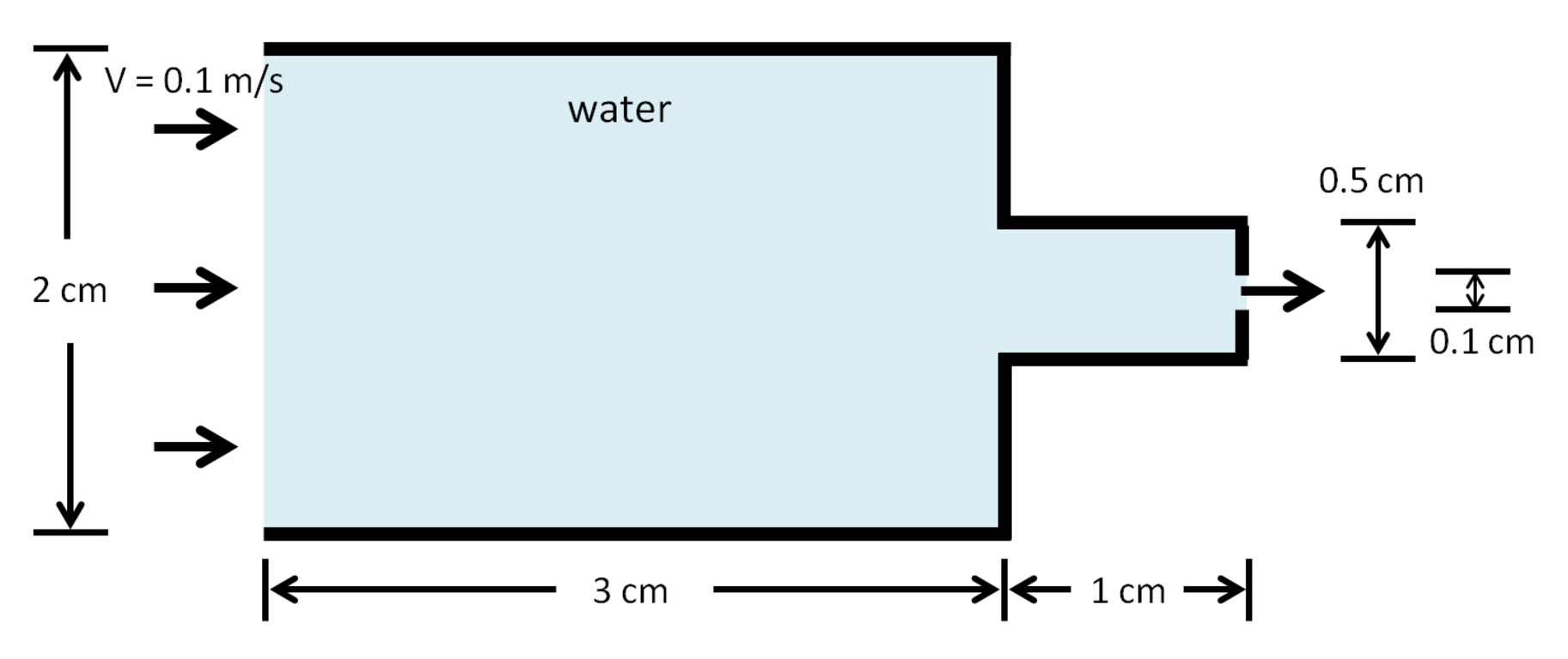

Please see the attached file for the very simple model of fluid flow I'm trying to simulate. I'm getting stuck on how to make the 0.1 cm opening.
Steps I've taken so far -
1. Made a 2D axisymmetrical component.
2. Added a rectangle of width = 2 cm, height = 3 cm.
3. Added a rectangle of width = 0.5 cm, height = 1 cm.
4. Union of Rectangle 1 and Rectangle 2.
Thanks in advance!

I think you make your model like this.
