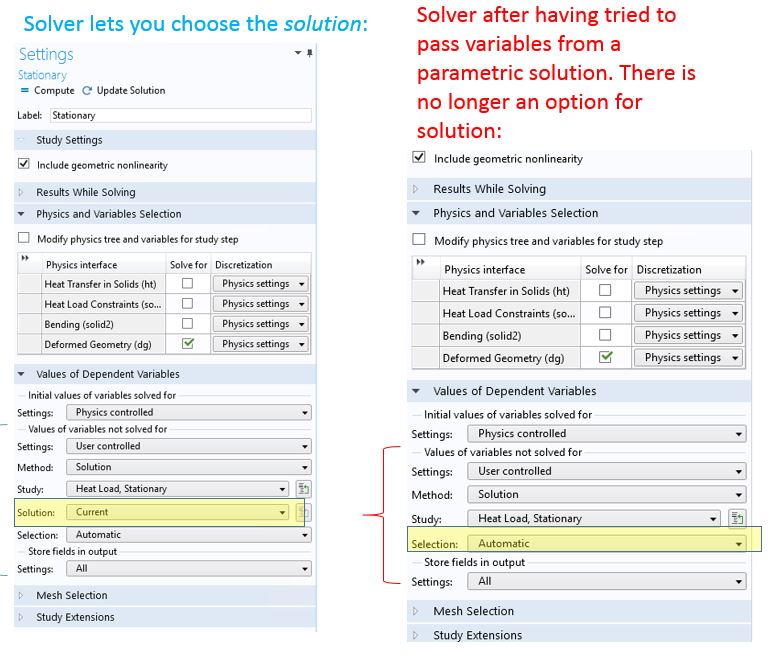

Hello everyone,
I ran in to a problem while trying to pass variables between three separate studies. The first study is a thermal stress study that runs a parametric sweep over various lengths of my geometry. The second study is a deformed geometry study that sets "variables not solved for" to be dependent on the first study. Finally, the third study, solid mechanics, sets "variables not solved for" to be dependent on the deformed geometry study.
I realize that sounds a bit confusing but it typically works quite well in making sure that the deformed geometry from the first study can be used in the third study. Unfortunately however, it does not seem to work with a parametric sweep. Within the deformed geometry study, I choose the solution corresponding to the desired parameter but it only seems to pass the first parameter solution on to the third study.
If anyone knows anything about this problem or needs more information please let me know. Thank you.
Nick
