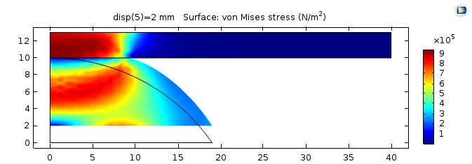

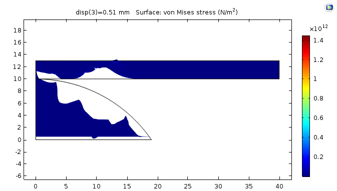

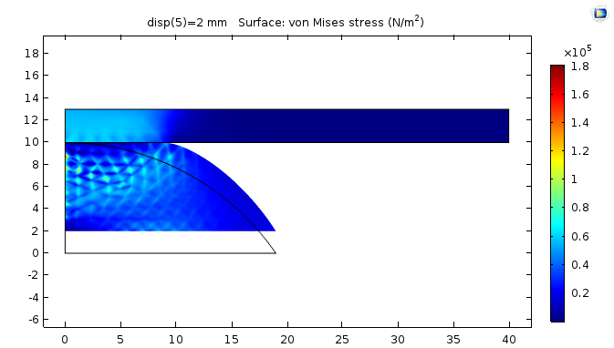

At 2 mm of compression, the resulting force was about 8.5 N. However, using the model I have with [Young's mod = 0.008 GPa, Poisson's ratio = 0.47], a total force of 220.7 N is calculated. By increasing the Young's modulus, this total force decreases but the model struggles to solve. Increasing the Poisson's ratio allows the model to solve at higher Young's mod values but the solutions don't always seem correct. e.g. with [Young's mod = 0.0005 GPa, Poisson's ratio = 0.4999] the total force = -18.718 N.
(the surface plots for the von mises stress of each of these examples are attached)

As for using the nearly incompressible material option, this causes even less convergence and stranger solutions such as the one attached
Thanks for your reply, Jeff Y and P are variables with the expression Young and Poisson respectively because I wanted to include these in my table. As for using the nearly incompressible material option, this causes even less convergence and stranger solutions such as the one attached
