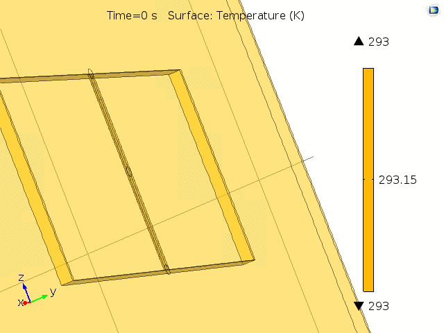

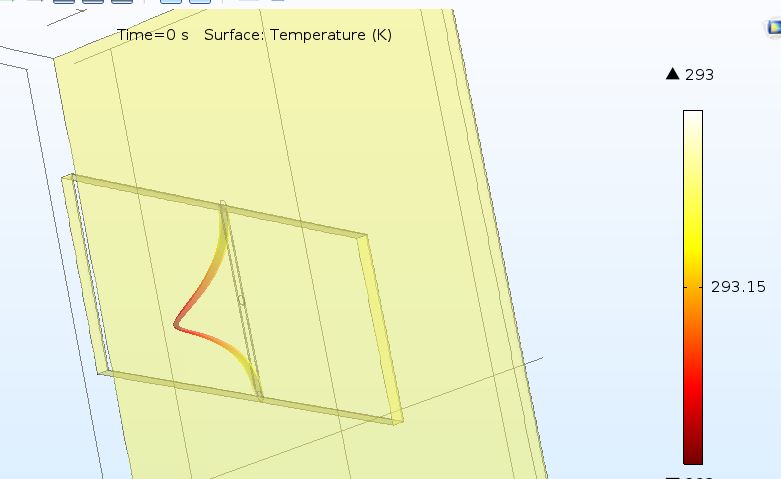

Hi, i'm trying to simulate a micro bridge heated by laser. The bridge seems to be moving but when i when i'm viewing the temperature differences, all the bridge seems to be at the same temperature...
The colors show a temperature difference but the values shows the same temperature..
I dont think its a range thing..

Alexandra,
Seems that you don't have appropriate temperature coupling - make sure you selected heat source domain and correctly defined heat source, or upload your model to get more specific answer to your question.
Sergei
