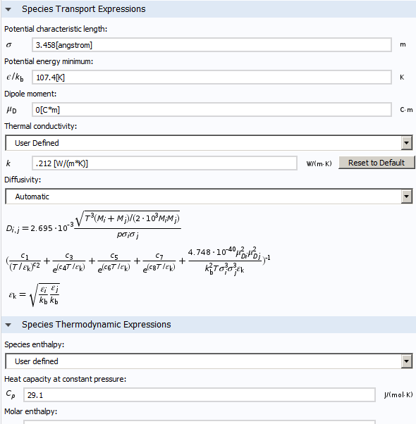

I can see how to get the specific heat capacity, and thermal conductivity of the mixture: I can enter a value for the property of each species, and then the software combines them into an effective mixture value.
But it seems impossible to get the dynamic viscosity (of a gas mixture without a solvent) unless I want to employ the relationships from kinetic gas theory (pg 51 of the user guide). I have the dynamic viscosity data of each species, relatively constant.
I would like to go to the individual species nodes and enter a (numerical) value for the dynamic viscosity of each gaseous species, but the software doesn't seem to want to let me do that..
I can see the variables defined in the [equation view] Chemistry node:
Its "chem.eta_speciesname1" and Its "chem.eta_speciesname2"
But I just can't see how to change / edit them?? Why COMSOL is so intent to block me from doing this? I can't seem to enter a user-defined value for the dynamic viscosity of the individual species...
