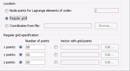

In V3.5a, I can define the number of x, y, z points in the 'export postprocesing data' panel as the first figure shows below, it's convenient to import the data to MATLAB for further calculation.

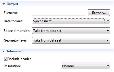

But in V4.1, I only can define the node points for Lagrange elements of order to define the location (second figure shows), and the exported data is an unordered matrix which can not be used in MATLAB.
Do COMSOL V4.1 cancel this function, or there are some other ways to export the data to a ordered matrix? Someone could help?
