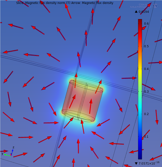

To see the results better right click Results 3D plot Group 1 + add Streamline Set Streamline Positioning to uniform density and 0.1 as separation distance
Then Results 3D lot Group 2 - Slice 1 set Plane Data Planes = 1

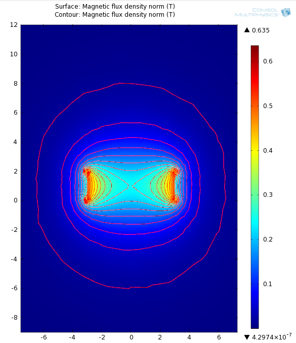

Right click Results - 2D Plot group 1 + add Surface plot + Update plot
Note: because of the rather coarse mesh chosen the filed lines might be somewhat staggered.
You might want to zoom in to better see the results
One thing you see clearly the sharp edges of your cylinder are creating singularities (observe how hey worsen with finer mesh) ideally in ACDC your should use rounded corners wherever possible to avoid such singularities, in particular when using the maxwell stress tensor for force calculations
To go further you might replace the sphere by a square cube and see how the field lines are influenced (or not depending on size) from the corners of the air box, just as you might make a smaller sphere and add a thin r)1/10) of air) "infinite elements "spherical" node

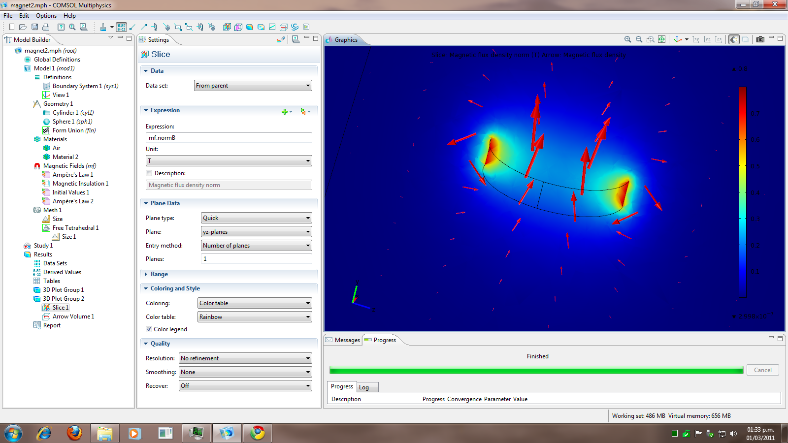

Posted: 1 decade ago 2011/03/01 7:14 GMT-5
Hi, Ivar. I followed your instructions from your second post but I still think there's something wrong somewhere, or maybe my electromagnetism is a little rusty. I'm attaching the file of my magnet. You'll see the field is stronger at the edges of the magnet when I think it should be stronger everywhere inside the magnet, with the rainbow gradually turning to blue on the outside.
Posted: 1 decade ago 2011/03/01 8:47 GMT-5
Indeed, one could believe so.
BUT I suspect that it's your mesh density that is also playing you a game there.
If you select the magnet itself and add a "tet" extremely fine mesh and then solve, you will see that the red region concentrates on the upper and lower edge (as these are singularities) and the external boundary.
Its more apparent if you turn off the smoothing and use a raw No Refinement Resolution for the graph. One should always check the shapes in raw mode, smoothing is nice but you can quickly be fooled by artefact's
If you round the edges off with a fillet radius this effect will reduce somewhat but the .
Hi Indeed, one could believe so. BUT I suspect that it's your mesh density that is also playing you a game there. If you select the magnet itself and add a "tet" extremely fine mesh and then solve, you will see that the red region concentrates on the upper and lower edge (as these are singularities) and the external boundary. Its more apparent if you turn off the smoothing and use a raw No Refinement Resolution for the graph. One should always check the shapes in raw mode, smoothing is nice but you can quickly be fooled by artefact's If you round the edges off with a fillet radius this effect will reduce somewhat but the . -- Good luck Ivar
Posted: 1 decade ago 2011/03/01 10:41 GMT-5
This is what I'm looking at. I followed your instructions and created an "Extremely fine" tetrahedral mesh for the magnet and left Mesh1-->Size at "Fine."

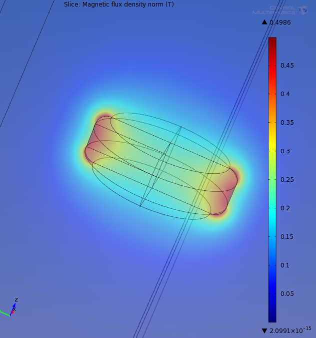

Posted: 1 decade ago 2011/03/03 10:59 GMT-5
I'm facing a different challenge this time. I've added both the coil and the magnet and a corresponding Ampère's Law 2 and External Current Density 1. If I compute this solution, I only get to see the magnetic field of the permanent magnet while the coil retains the colour of the normal plane. If, however, I disable Ampère's Law 2, then I see the magnetic field of the coil and, obviously, the permanent magnet is now the blue, inactive, element. I'm guessing there's some kind of conflict between the two, maybe one overrides the other? Is there a way to see the magnetic fields of both elements in the same slice? Thanks.

Posted: 1 decade ago 2011/09/22 16:02 GMT-4
I'm afraid regarding the singularity problem, I have the similar question. Is it simply because of the corners that caused such nonuniform distribution of the field strength in the magnet? I attached a similar picture of the cylindrical magnet resulted from my simulation. Thank you very much!
Posted: 1 decade ago 2011/09/22 16:13 GMT-4
Hi, Ivar,
I tried your method based on your model but still get more red on the edge. I don't understand and am totally confused. I'd really appreciate if you could give me some help on this. Thank you so much!
Chang
Hi, Ivar, I tried your method based on your model but still get more red on the edge. I don't understand and am totally confused. I'd really appreciate if you could give me some help on this. Thank you so much! Best, Chang
Posted: 1 decade ago 2011/09/22 16:40 GMT-4
However, when the geometry's aspect radio gets close to unity or greater, it becomes more uniform. Now I'm confused if it's physics or it's artifacts due to the simulation boundary setting, etc.
Posted: 1 decade ago 2011/09/23 10:01 GMT-4
I have been out of houise for some time ;) for me the field concentration ou nthe outer part of the coil is normal, in the sens that depending on the physics and BC you use you will have (or not at all) the effect on the current density by the field itself, that will push the current to the edges (skin effect). this is also very frequency dependent. Mostly with simple analytical means one forget these "2nd order" effect, even if they are often far from negligible.
But they can only easily be shown with tolls like COMSOL (and there are not many).
So sharp edges = singularities = partially wrong results for numerical reasons,
but current densities tending to increase at the outer border = physics applied correctly, and is a "feature" of a bulk coil
That is also why one tend to use multiple turn small wire diameter, or even coils made of thin films and not wires. Just as for higher frequencies, the current rtend to circulate at the border of the conductor and NOT in the middle, as the electroncs are repelled from centre by the generated magnetic field
Hi I have been out of houise for some time ;) for me the field concentration ou nthe outer part of the coil is normal, in the sens that depending on the physics and BC you use you will have (or not at all) the effect on the current density by the field itself, that will push the current to the edges (skin effect). this is also very frequency dependent. Mostly with simple analytical means one forget these "2nd order" effect, even if they are often far from negligible. But they can only easily be shown with tolls like COMSOL (and there are not many). So sharp edges = singularities = partially wrong results for numerical reasons, but current densities tending to increase at the outer border = physics applied correctly, and is a "feature" of a bulk coil That is also why one tend to use multiple turn small wire diameter, or even coils made of thin films and not wires. Just as for higher frequencies, the current rtend to circulate at the border of the conductor and NOT in the middle, as the electroncs are repelled from centre by the generated magnetic field -- Good luck Ivar

Posted: 1 decade ago 2012/02/08 16:00 GMT-5
Hey, sorry to post on an old forum, but my question closely follows this one.
I'm trying to model two permanent magnets in close proximity to one another. I'm on an education (through the university) license, and therefore only have access to 2D Magnetic Fields. I can't do Magnetic Fields with No Current on 2D or 3D, and I can't do Magnetic Fields in 3D... It's all symmetrical so it should be fine. My question is whether or not I can do my modelling of permanent magnets using the 2D axisymmettric MF module.
I was trying to follow www.comsol.com/showroom/documentation/model/78/, but obviously couldn't since I don't have access to that module.
I was able to semi-recreate what you had posted in post #2, and that seems to help.. I just want to make sure that this module is giving me accurate models.
