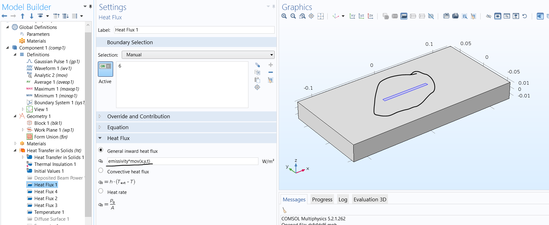

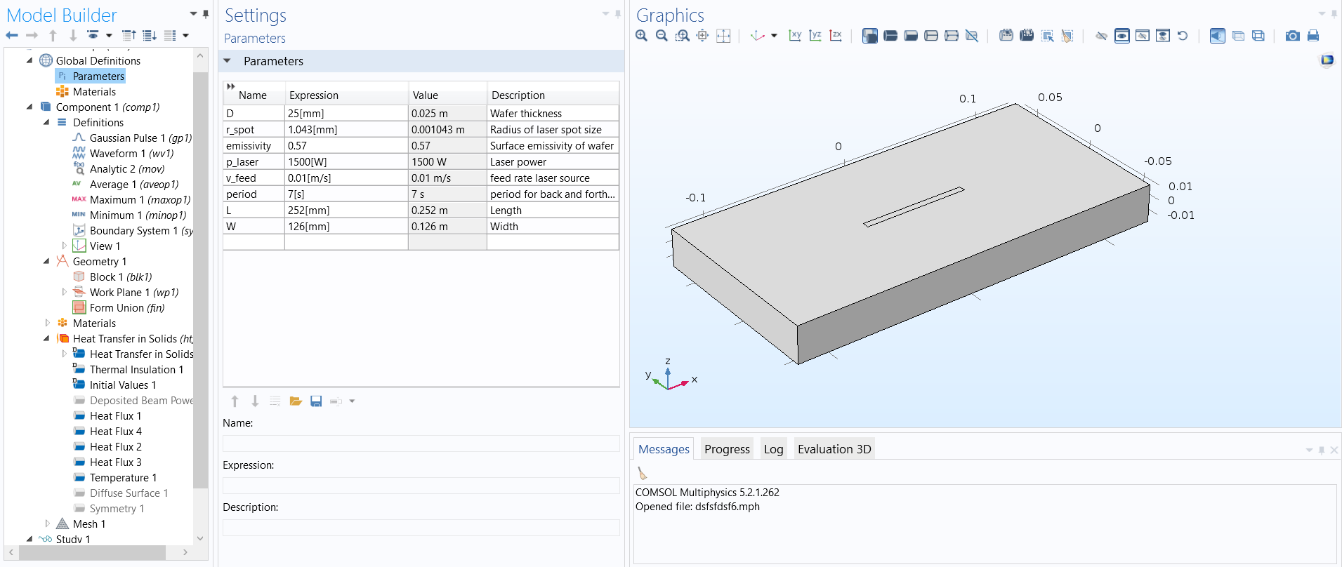

I have seen the model provided by comsol "Heating of Silicon Wafer". I tried to implement the same principle in my model. The problem I am facing is that I should get temperature in range of 2000 or 2500 Kelvins but instead I am getting temperatures in range of 21000 Kelvins. I have tried to contact comsol support a couple of times but couldn't get much help.

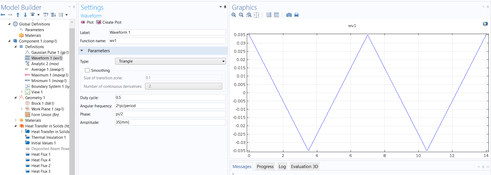

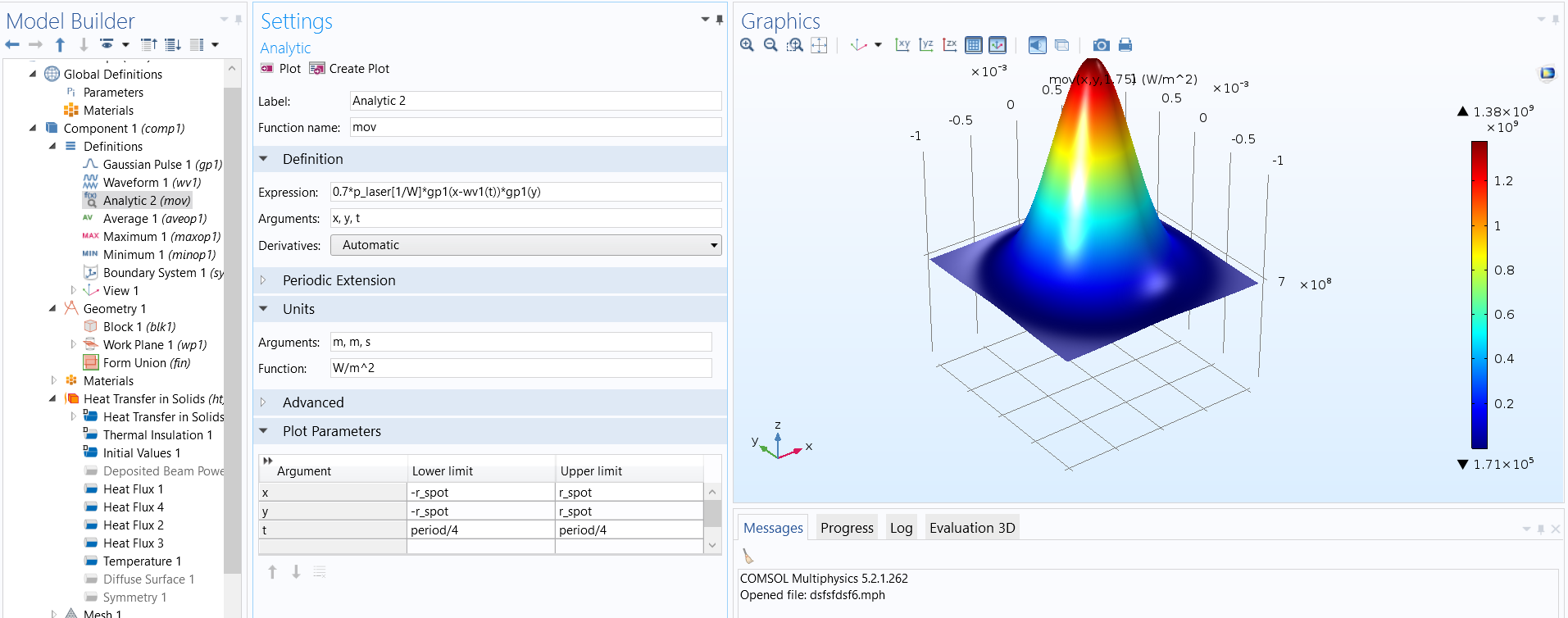

I am doing my Masters thesis for which I have to make a model describing Laser Metal Deposition process. For now, I am only interested in temperature profile of the process. The velocity of laser beam is defined through the waveform function where I consider that I take laser beam 7 seconds to move back and forth i.e., from -35 mm to 35 mm. An analytical function is then defining the Laser beam itself as "0.7*p_laser[1/W]*gp1(x-wv1(t))*gp1(y)" where 0.7 describes the fact that 70 % of beam power Efficiency. Then a small area is defined on the geometry because I reduced my mesh size to extremely fine to implement laser beam correctly in this area and to reduce the computational time, I made an area through "work plane 1". I used Ti6Al4V[solid, polished] through COMSOL material library. As for this material, the conductivity is only defined from 0 to 800 Kelvins so I defined myself conductivity above 800 Kelvins for this material by consulting the source "Boivineau, M., et al. "Thermophysical properties of solid and liquid Ti-6Al-4V (TA6V) alloy." International journal of thermophysics 27.2 (2006): 507-529."

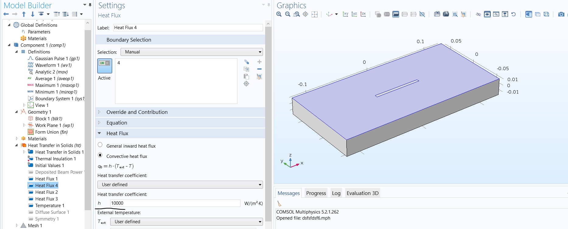

I used heat transfer in solids interface. The heat flux node defines the Laser Beam. Heat flux 2,3,4 are defining the cooling process during Laser Metal Deposition. Actually, I was expecting to get temperatures in range 2000 to 2500 Kelvins but with my first few tries, I got temperatures in range of 21000 Kelvins, that's why I put heat transfer coefficient h=10000 for heat flux 2,3,4. The temperature of bottom of plate is fixed at room temperature.
Please help me what should I do? Where am I wrong?
