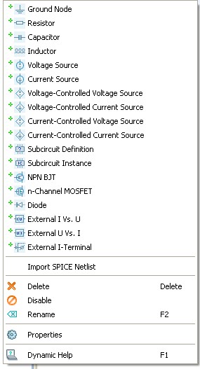

Here is a screen shot of what you can do with COMSOL "spice". See attached picture.
Not everything that you can do in LTSpice, Orcad, etc, can be done in COMSOL. It is fairly limited and primitive.
I am only aware of one example file in the model galleries here that shows how to link up spice and COMSOL. Does not seem to be well documented feature.
Descriptions of how the electrical interface works is in the RF Module documentation.
When you import a netlist, they have to end with a .cir extension.
If you do not follow the correct spice format, COMSOL will tell you so.

you should be able to use "arbitrary behavioral" elements. these are the dependent sources that are listed in the image i attached above. things like a voltage controlled voltage source and so on. in spice lingo these are E, F,G,H elements. if may not be a pretty spice model but you can do it.
