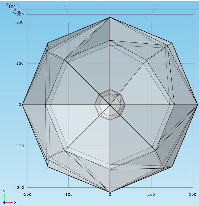

When using a geometric order greater than 1, are the nodes, that are not located at the vertices and thus not displayed located at the boundary of the discretized body?
Please find attached a picture of the illustration, that appears when I use the options "automatic" or "Quadratic" in the field "Geometry shape order" and the option "Quadratic" in the field Discretization => Temperature.
I am trying to discretize a hollow sphere. Shouldn't the elements next to the boundary be a little bit more round? Otherwise there would be, as far as I know, an unneccessary geometric discretization error. Or is the curvature just not displayed?

The curvature is not displayed.
The curvature is not displayed. Jeff
