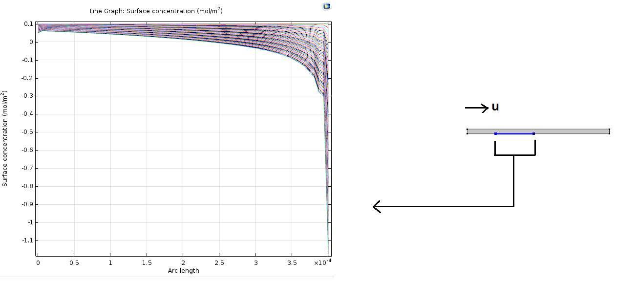

No,it starts at the edge of the reaction surface, but as time increases a greater portion of the surface reaches a negative concentration. I've included a picture of the domain i'm talking about.
i've tried refining the mesh from extra course to finer, and decreasing the initial step size of the solver to 1e-10 but it gave the same results.

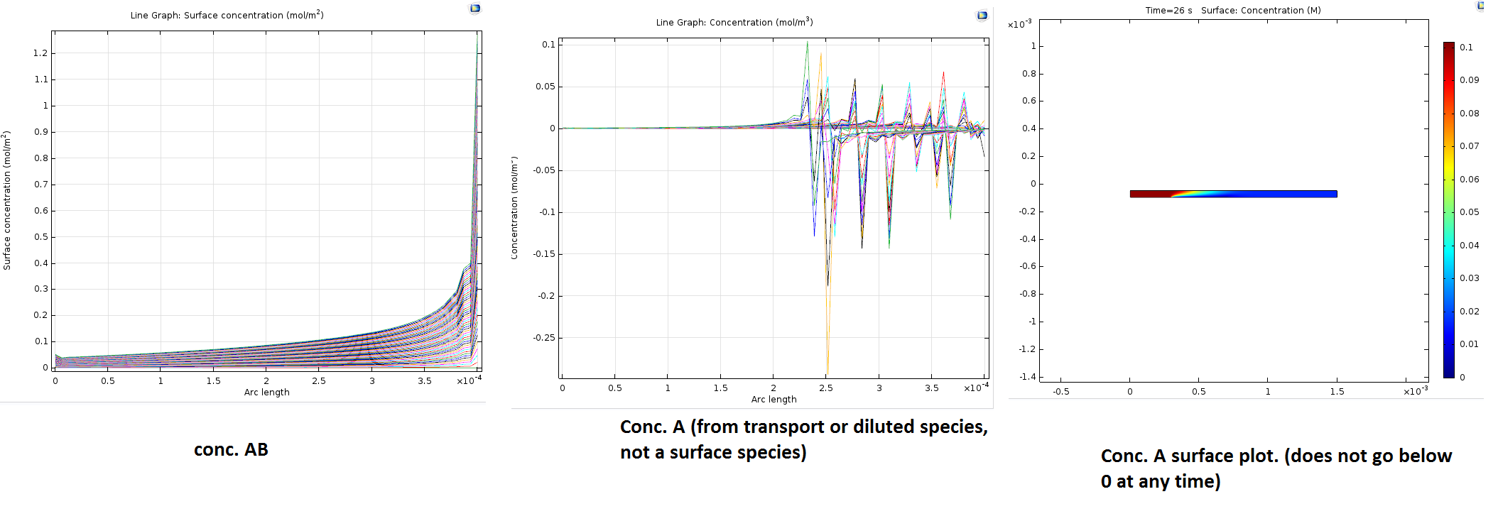

here are the plots of concentration AB on the surface. and Concentration A along the surface. (although last one is taken from the transport of diluted species data because A is not a surface species.) i also included the contour plot of the concentration of A inside the domain, which i never see falling below 0.
Sorry man, I am stumped. With your B concentration going negative, you should have a negative reaction rate, which should cause the generation of species A instead of consumption. But your A contour plot looks perfectly normal.

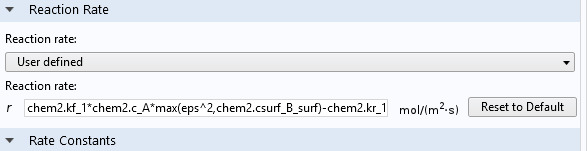

Just put "max(eps^2, R)" where you would put the user defined reaction rate. With R being your actual reaction rate. This should fix the issue.

thanks! i've put the term around my reaction rate term of the species which went negative in concentration. It seems to have fixed the issue!
