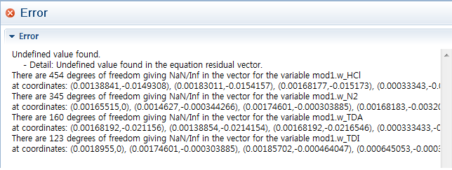

Posted: 1 decade ago 2011/03/16 15:07 JST
Hi !!
my model is axial symmetry !!
so, the unit of mass rate is mol/s !!
and i consider a density change in my system. so i select concentrated species module !
but when i choose compressible flow(Ma<0.3), i have a error
( incompressible flow is not !! it has not error )
error massage is attached. !!
Hi !! my model is axial symmetry !! so, the unit of mass rate is mol/s !! and i consider a density change in my system. so i select concentrated species module ! but when i choose compressible flow(Ma
Posted: 1 decade ago 2011/03/16 22:17 JST
but for incompressible flow you won't be able to conserve rho*u quantity which is not acceptable under any situation.. if possible contact support, they will help you with this error message..
good luck
Mayur
but for incompressible flow you won't be able to conserve rho*u quantity which is not acceptable under any situation.. if possible contact support, they will help you with this error message.. good luck Mayur
