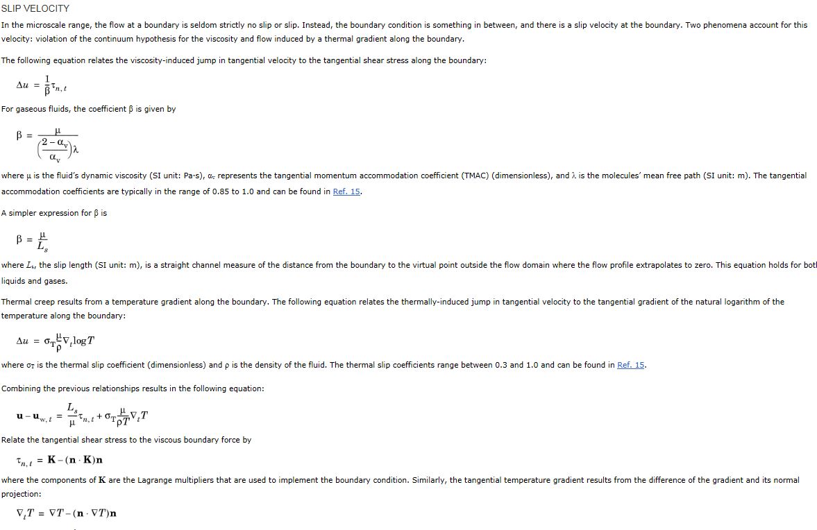

please, I need to understand the system of equations of the slip velocity and the jump temperatre in the wall boundary condition.
I work with "High Mach Number Flow" module.
If you can give me any reference article that demonstrate the same equations used in comsol, I will be very thankfull.
in the attached figure, the assumptions equations used in COMSOL.
Thank you in advance.
