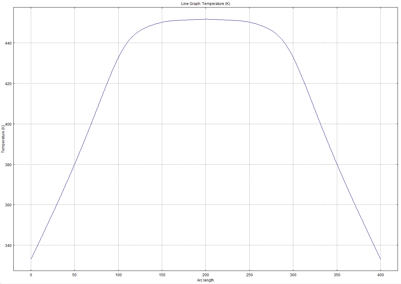

What I did in COMSOL:
- Linear Graph of a 1D Plot Group to get the temperature profile on a edge (Data Set named "Edge 2D 1") of a 2D geometry (this look like attachment #1).
What I'm trying to do: Calculate the STANDARD DEVIATION of the temperature profile on that edge (for further modification of geometric parameter to optimize it).

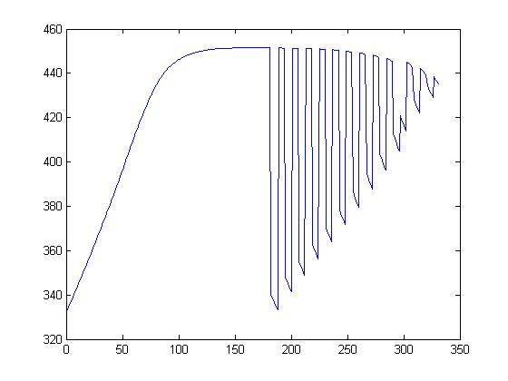

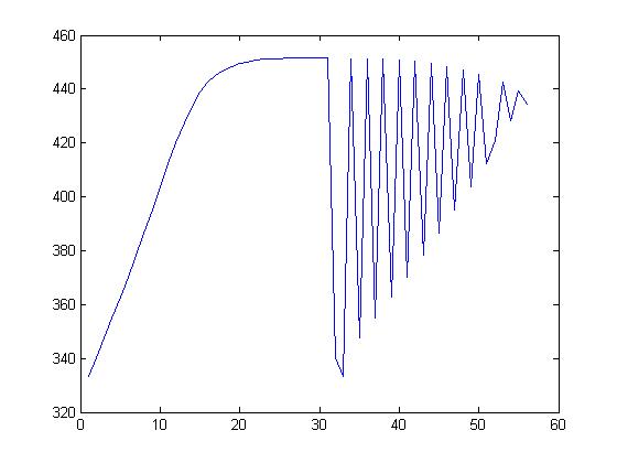

What I have been TRYING to do in MATLAB:
- Get the temperature values on my edge by using (after exporting my model from COMSOL to the COMSOL server):
[myTemp] = mphinterp(model, ['T'], 'dataset', 'edg1')
That doesn't work, it gives me data for half of my edge and afterwards it's all over the place (see attachment #2) (I guess I would need to sort out my values but why isn't it following the arc length?)
I also tried:
myTemp = mpheval(model, 'T', 'edim', 1, 'selection', 3)
which gives me a structure which contains my temperature data but once again my data are all scrambled up when I try to plot them (see attachment #2)
Any ideas why this is so scrambled up? I just want to calculate the Standard Deviation which shouldn't be that hard!
