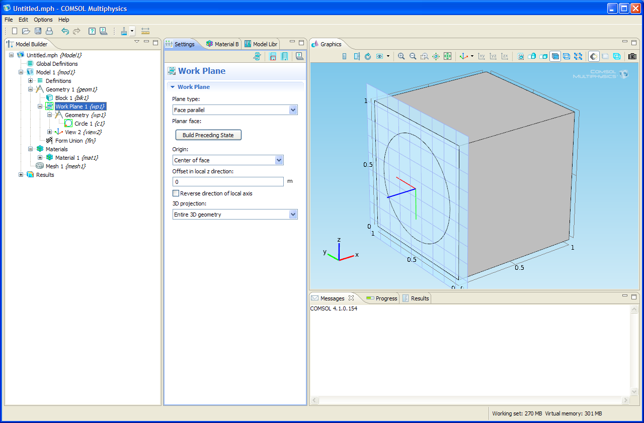

All I can find in 3D geometry view are functions to draw 3D objects. But I need to draw a circle on a suface of a block in order to set boundary condition on it. Any one can help? Thanks,

set a work plane on the surface, and draw a circle in there, then make an embedded "surface"

In 4.1, the "embedding" is implicit, so all you need to do is to create a work plane that represents the block surface and then draw the circle on that work plane's geometry. Then finalize the geometry (by moving on to the physics settings, for example). The circle then defines a separate surface so that you can specify another boundary condition in that area. See the attached screen shot.

Hi, In 4.1, the "embedding" is implicit, so all you need to do is to create a work plane that represents the block surface and then draw the circle on that work plane's geometry. Then finalize the geometry (by moving on to the physics settings, for example). The circle then defines a separate surface so that you can specify another boundary condition in that area. See the attached screen shot. Best regards, Magnus Ringh, COMSOL

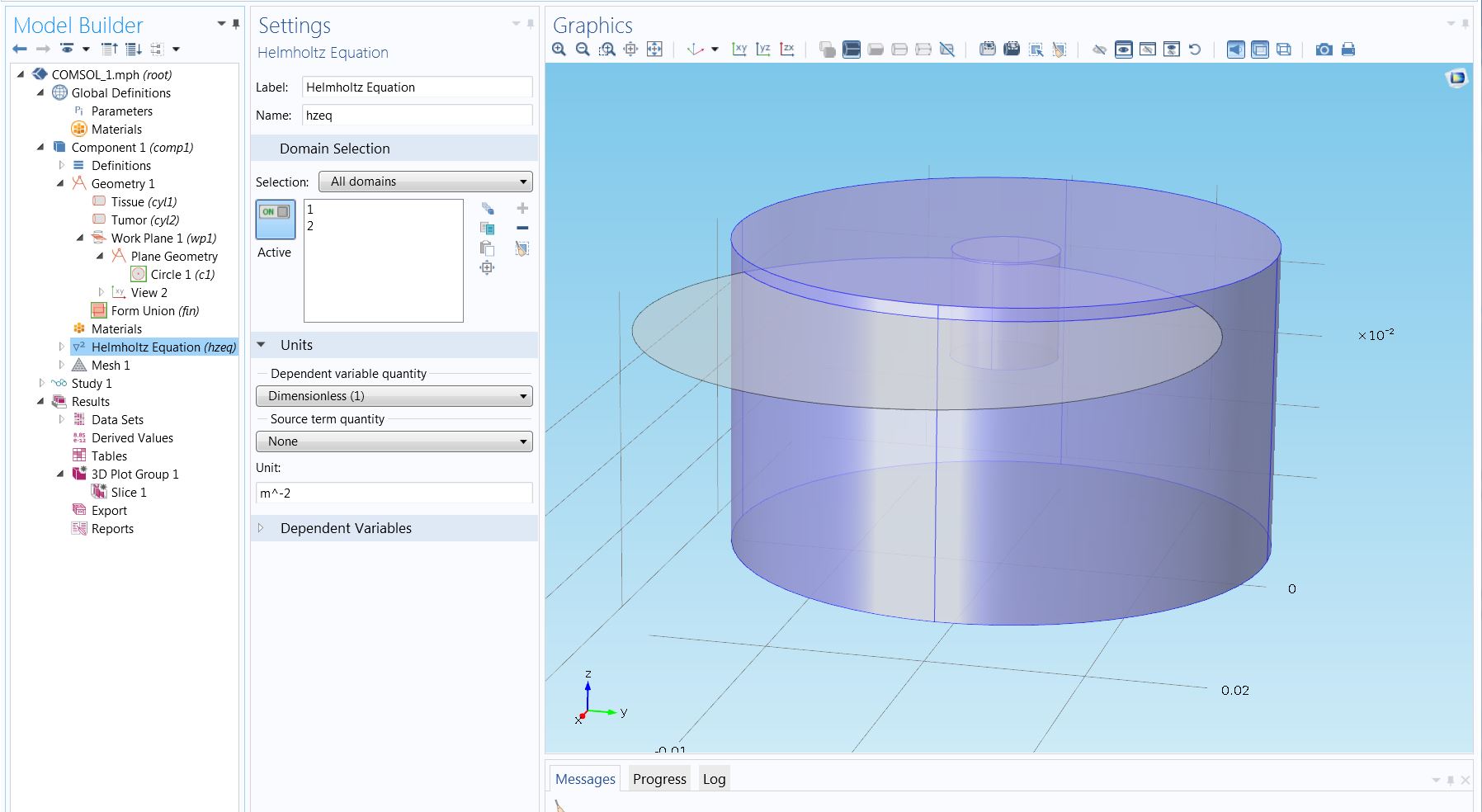

Hi Magnus,
Thanks for sharing! I came across this post as I encountered similar problems. I followed the steps and built a circle on the work plane. But when I go Helmholtz Equation (hzeq), the circle on that work plane is not included in the "all domain" selection. I cannot add source value to the circle. Is there any step I miss? How can I solve the problem? I'm using comsol 5.1. Attached is a figure showing the issue.
Thanks in advance for your response!
Jianshan
Hi Magnus, Thanks for sharing! I came across this post as I encountered similar problems. I followed the steps and built a circle on the work plane. But when I go Helmholtz Equation (hzeq), the circle on that work plane is not included in the "all domain" selection. I cannot add source value to the circle. Is there any step I miss? How can I solve the problem? I'm using comsol 5.1. Attached is a figure showing the issue. Thanks in advance for your response! Jianshan
Jeff Hiller COMSOL Employee
Posted: 9 years ago 2016/04/20 0:23 JST
Hello Jianshan,
A disc is not 3-dimensional, so it does not define a domain in 3D and you can therefore not assign an equation to be solved on a 3D domain to it. In 3D, you could use a disc to assign a boundary condition, or a PDE defined on a surface, etc.
