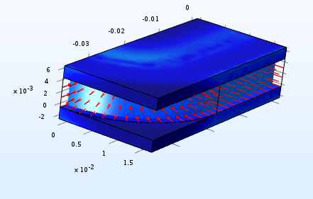

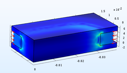

I've been facing a problem for I while, and I would appreciate any help for this issue.
Basically, I have to components, I apply a pre-compression to the external boundaries of one of them and compute the contact pressure existing in both (see attached pictures). Then, I would like to use this solution (deformation and contact pressure) as a point of start in a transient (not necessarily transient?) thermo-mechanical analysis and see how the contact pressure is being relieved.
I am able to compute both studies separately, but without success when it comes to couple both studies.
I've seen that under "Dependent Variables", and activating "initial values for variables solved for", I can select the solution given by the stationary solver, but It doesn't work.
Any suggestions?
