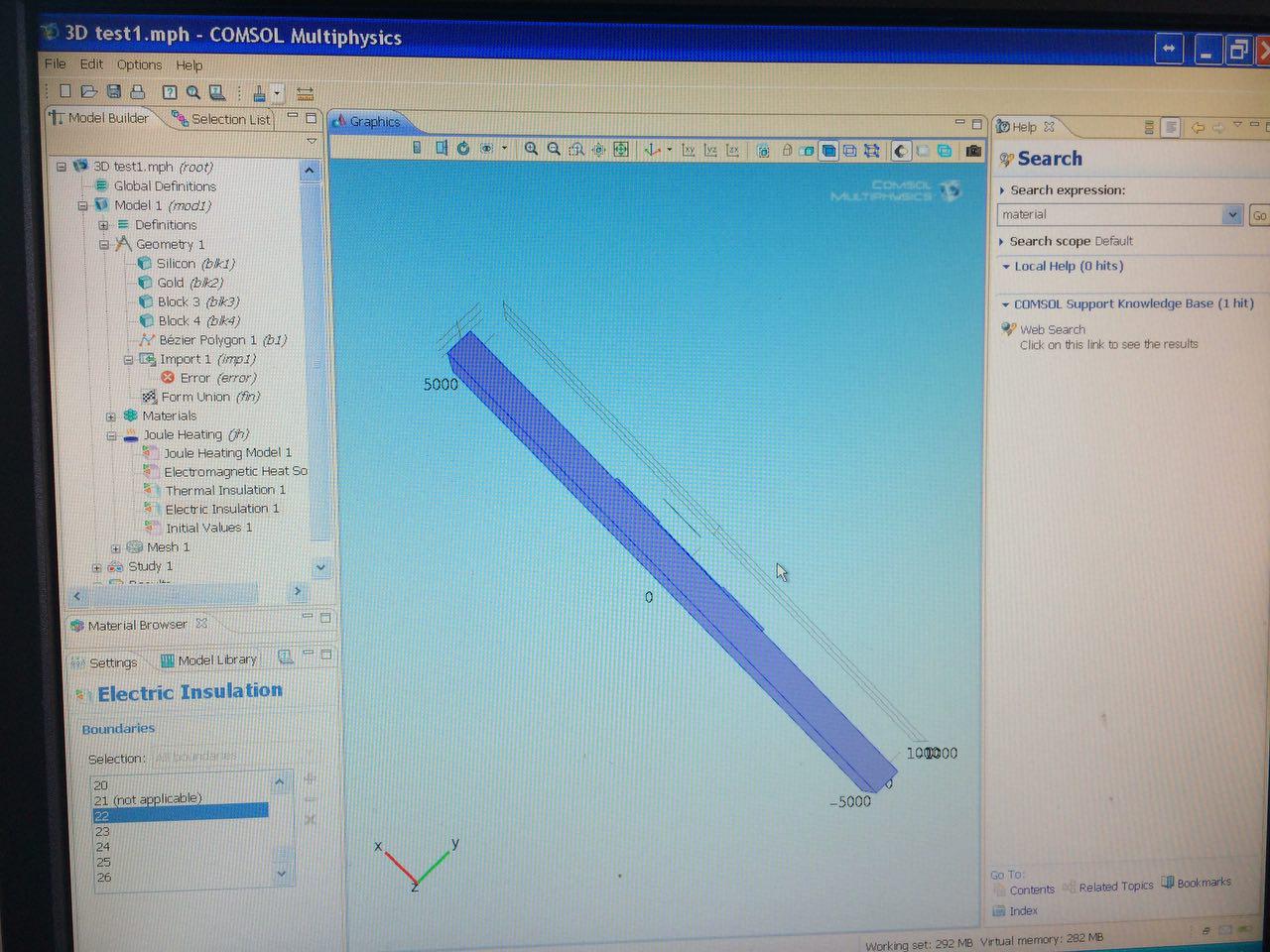

Posted: 8 years ago 2017/08/18 3:45 JST
Yes, sure. It is attached.
Boundaries are shown in the left bottom corner but I can't define them.
Yes, sure. It is attached. Boundaries are shown in the left bottom corner but I can't define them.
Jeff Hiller COMSOL Employee
Posted: 8 years ago 2017/08/18 3:52 JST
That's not version 3.5a. It's some flavor of version 4.
The GUI changed thoroughly at version 4.0, so you won't be able to follow instructions written for 3.5a with this 4.x installation.
