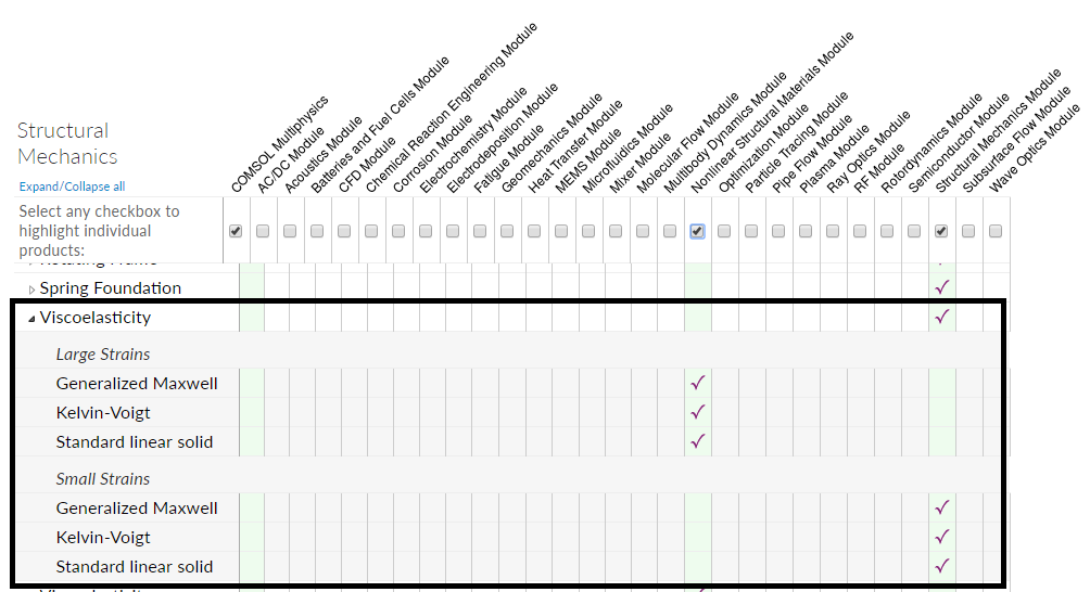

Jeff Hiller COMSOL Employee
Posted: 8 years ago 2017/07/11 14:23 GMT-4
Hello Bhuvan,
Viscoelastic materials are available only if your license includes the Structural Mechanics Module. They are not available among the structural mechanics capabilities of the core COMSOL Multiphysics. More options are available if your license includes both the Structural Mechanics Module and the Nonlinear Structural Materials Module. See the attached exerpt from the online product specification chart (www.comsol.com/products/specifications/),
To determine whether your license includes either of those products, go to File > Used and Licensed Products.
Hello Bhuvan, Viscoelastic materials are available only if your license includes the Structural Mechanics Module. They are not available among the structural mechanics capabilities of the core COMSOL Multiphysics. More options are available if your license includes both the Structural Mechanics Module and the Nonlinear Structural Materials Module. See the attached exerpt from the online product specification chart (https://www.comsol.com/products/specifications/), To determine whether your license includes either of those products, go to File > Used and Licensed Products. Best, Jeff
