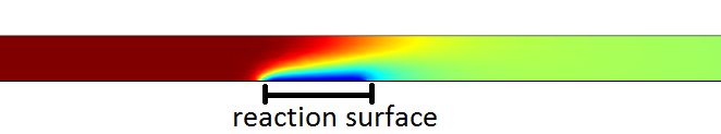

I am trying to estimate some parameters (Kon, Koff) for a surface reaction in a microchannel. The surface reaction is happening along a small part of the boundary in a 2D space. i have the surface reaction module set up to monitor the surface concentration of the formed species (cs_AB).

the surface concentration is stored in the variable cs_AB , however when I enter this variable in the parameter estimation module (in the expression field for value), it gives the error that the expression 'cs_AB' is not known while solving. also entering 'comp1.cs_AB' gives this error.although in the parameter estimation equations view, it recognizes the expression and automatically labels it as a 'surface concentration'. is the surface reaction module even compatible with the parameter estimation?
my reference data actually contains the integral of the surface concentration along the boundary. is there a way to integrate the found surface concentrate cs_AB along my boundary, and then use this value to fit my parameters to the reference data?
