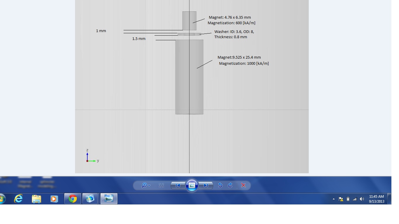

Hi Folks,
My problem is that my simulation results do not agree with the experiment results.
I have two cylindrical Neodymium magnets of sizes shown in the attached file, and an Iron part between them. I measured the magnetic field of the magnets using a Gauss meter and they perfectly match with the simulation, in various distances.
I need the magnetic force in two situations:
1- The magnetic attraction between the small magnet and washer: in this case the magnetization for the big magnet is zero. The force I get from simulation is 0.3897 N but from the experiment that force is more than 0.8 N.
2- Magnetic attraction between small magnet and big magnet when the gap between small magnet and washer is 10 mm (instead of 1 mm): in this case the magnetization for the big magnet is 1000 [kA/m]. The force I get from simulation is 0.2272 N but from the experiment that force is more than 0.6 N.
I also did a 2D axisymmetric simulation which gives the same results.
Thank you in advance for the help.
Mahdi
Hi Folks, My problem is that my simulation results do not agree with the experiment results. I have two cylindrical Neodymium magnets of sizes shown in the attached file, and an Iron part between them. I measured the magnetic field of the magnets using a Gauss meter and they perfectly match with the simulation, in various distances. I need the magnetic force in two situations: 1- The magnetic attraction between the small magnet and washer: in this case the magnetization for the big magnet is zero. The force I get from simulation is 0.3897 N but from the experiment that force is more than 0.8 N. 2- Magnetic attraction between small magnet and big magnet when the gap between small magnet and washer is 10 mm (instead of 1 mm): in this case the magnetization for the big magnet is 1000 [kA/m]. The force I get from simulation is 0.2272 N but from the experiment that force is more than 0.6 N. I also did a 2D axisymmetric simulation which gives the same results. Thank you in advance for the help. Mahdi

Mahdi,
the thread above gives really valuable hints for this kind of issue. Did you consider all aspects that were already mentioned, such as meshing and geometry aspects?
Your model geometry doesn't look like you did, e.g. you have sharp corners and edges in the geometry.

Edgar,
Thank you for your response. I tried different mesh sizes and it changes the results very slightly. I also tried fillets of various sizes on my 2D model, the results gets even worse, perhaps because the total volume decreases. I upload my 2D model here, I appreciate your help. Mahdi
Edgar, Thank you for your response. I tried different mesh sizes and it changes the results very slightly. I also tried fillets of various sizes on my 2D model, the results gets even worse, perhaps because the total volume decreases. I upload my 2D model here, I appreciate your help. Mahdi
