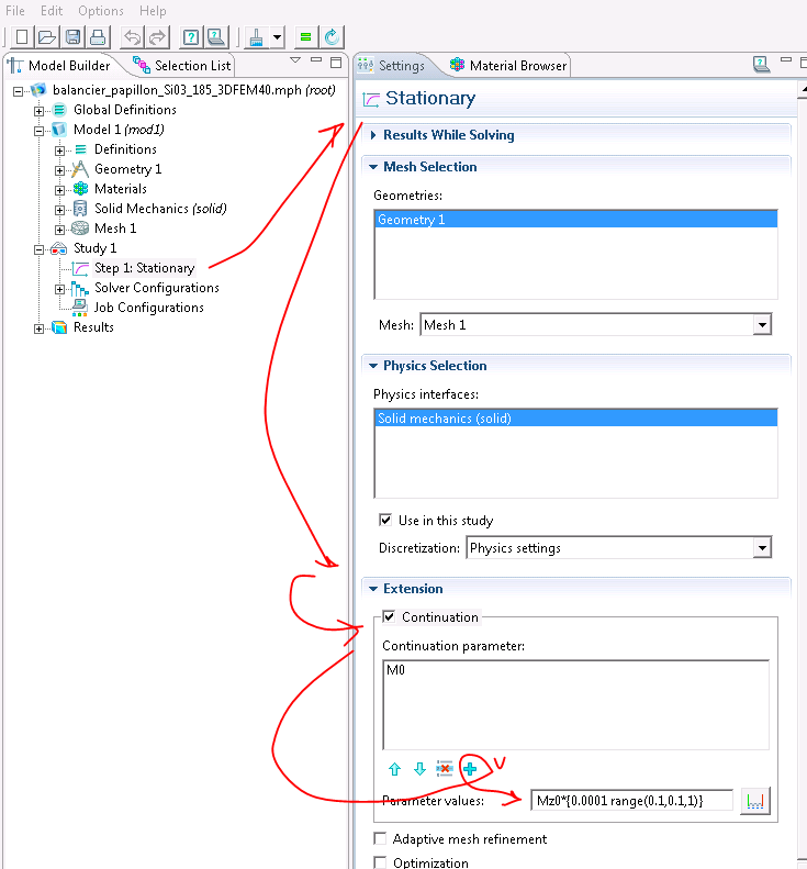

I am running a stationary study where a gravitational force is being applied to a deformable geometry that is undergoing "large deformation." The nonlinear solver is having issues, and based on previous posts in this forum, I think it is partially because a large force is being applied suddenly.
Is there a way to apply a ramping force in a stationary study where there is no time variable? The ramp function seems to ramp up the force as a function of time, so I don't understand how I can use it in a stationary study. Thank you.
