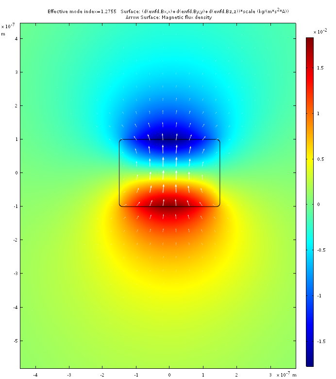

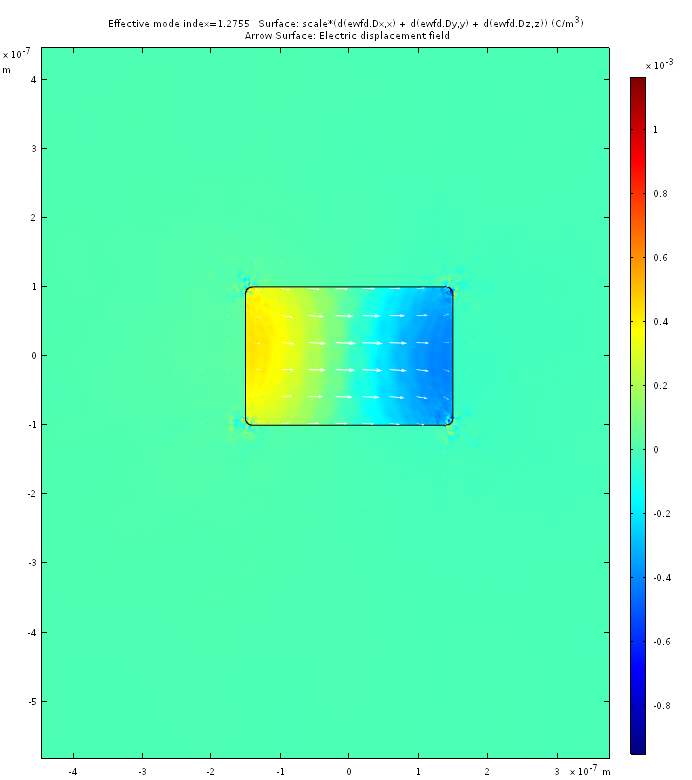

I have investigated the charge and current densities, and was not satisfied with the results. The divergence of the D and B fields is non-zero (attached) -- which is a non-physical result. Refinements to the mesh do not cause these quantities to converge to zero.
The reason the divergences is non-zero is due to the master equation for the Wave Equation physics interface does not require them to be. Is there a way to transform these solutions to satisfy these constraints? Is it possible to constrain the solver to set these quantities to zero?
