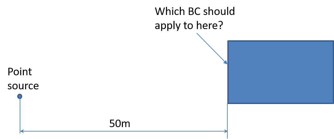

I am trying to figure out how to simulate a boundary condition applied to a plane as sound waves transmitted from a very far point source. For exemple, I want to simulate the sound waves transmitted through a system from a 50 meters away point source. However, we can not simulate it in COMSOL. So I want to simulate a boundary condition in front of the system as sound waves come from a source point. How can I do that?
I have attached an image below how I want it to be.

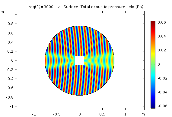

Actually, you can simulate distant acoustic point source in Comsol. Use "Background Pressure Field" option to specify source location and specify "Pressure field type" (Cylindrical wave in 2D or Spherical wave in 3D) to represent point source, as shown in the attached conceptual example. If your system is solid then use "Acoustic-Solid Interaction, Frequency Domain" physics interface to account for interaction of the acoustic wave with your system.
