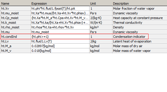

I am modelling heat and moisture transfer in closed chamber using heat transfer module and transport of diluted species module. In order to detect condensation in moist air I used the feature already available in comsol " condensation indicator". However I couldn't find any equation so far about how the "condensation indicator is calculated or the physics behind.
does anyone have any idea about the condensation indicator and how it is calculated ?
