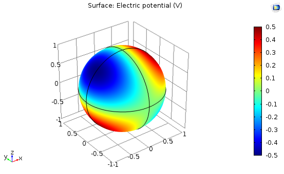

Consider a geometry containing just of a unit sphere. On the surface of the sphere we apply a potential boundary conditions of the form , where and are the spherical coordinates. When plotted, it looks like this (potential_boundary_condition.png):

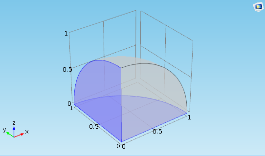

Now, I want to solve for the electric potential inside the whole sphere. Because of the obvious (anti)symmetry, it is tempting to split the simulation domain and consider only one quadrant of the whole geometry (keep in mind that I would like to use these principles in solving more complex but still (anti)symmetrical models). Is it possible to impose an antisymmetry condition to the highlighted faces (antisymmetry_faces.png)?
