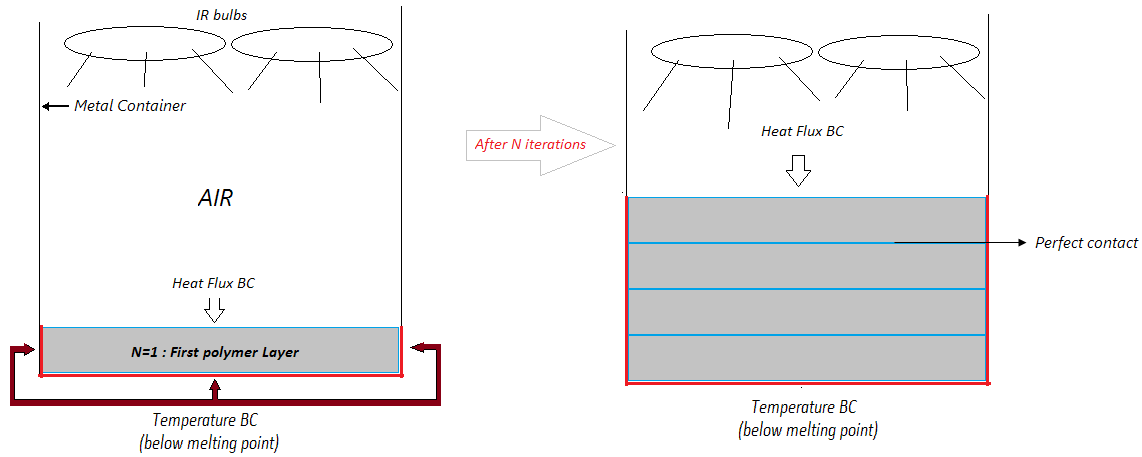

I am simulating the heating of a polymer layer by INFRARED bulbs taking into account a partial phase change (Enthalpy method) from solid to liquid phase. Then after the cooling, I want to add another layer of the same polymer with the same properties and thickness and re-do the same operation of heating and cooling until I have completed my N-layer model.
Until now, i succeeded to simulate the heating of one layer in time-dependent mode, The TRICK is I don't know how to implement the geometry build-up in each iteration and how to force the solution of layer "N" to be the BC for layer "N+1"

Please find attached my model (N-layer polymer.mph) and an image (concept.png) describing what I am trying to simulate here.
Ali
