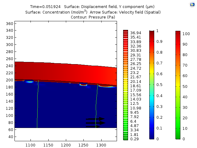

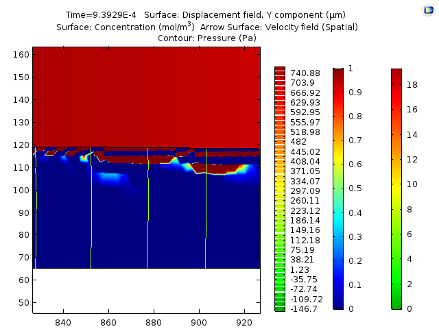

For my problem i have selected the actuation of a flexible membrane. My problem is that at some point during the simulation i see a blow up of the concentration in the area where my mesh is deformed.
Please find attached an image of the situation. I have fixed the color bar of the concentration to get a better view of the problem. If not fixed values for 10^8 and beyond are found in single locations colouring everyhting else as ~0.
My hope is that somebody can give me directions into solving this problem.
Things i tried: - Changing initial concentration from 0 to 1. The result is a blow up at an earlier timestep. - Conservation of mass in the diluted species interface: no result. - Pressure point constraints: no result. - Concentration=0 point constraint at fluid-solid interface where membrane deforms: no result
