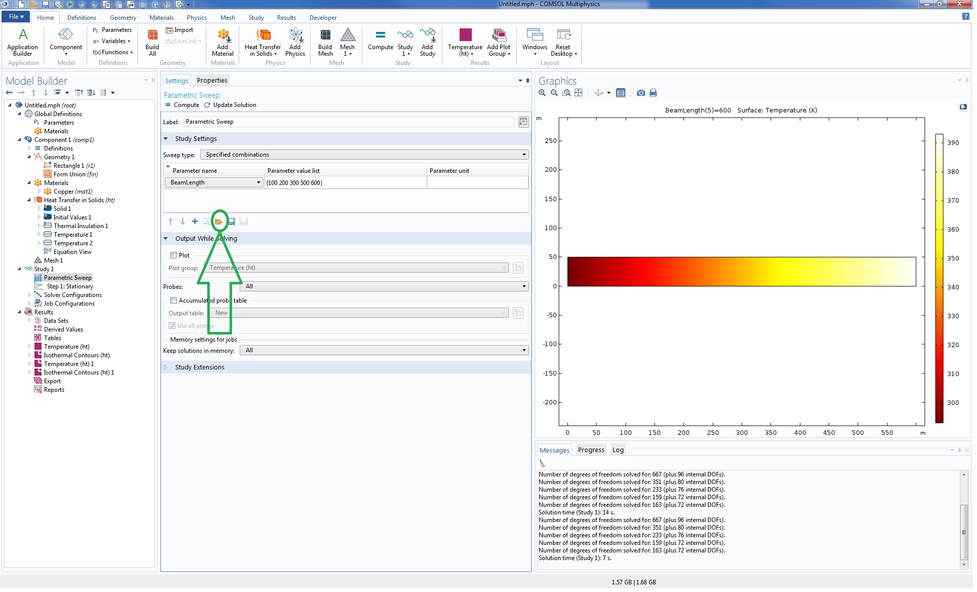

I need help in doing a parameterised study.
How can I load a table of values in text format to perform parametrised sweep study?

Hello Vineet,
You use the "Load from File" icon located on the Parametric Sweep window, then browse to the text format file containing the parameter names and values. See the attached files for an example.
Jeff Hiller
Hello Vineet, You use the "Load from File" icon located on the Parametric Sweep window, then browse to the text format file containing the parameter names and values. See the attached files for an example. Best, Jeff
