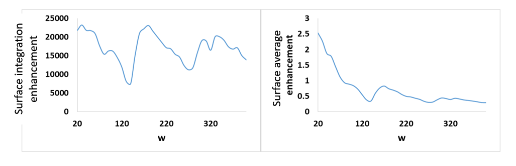

I am sweping a structure width of gold which placed on the top of GaAs. Light is normally incident on the structure. I want to calculate the light intensity in the GaAs. which one should I use surface integration or surface average to get the right values? I am using this equation (emw.normE^2). I attached two imgs
