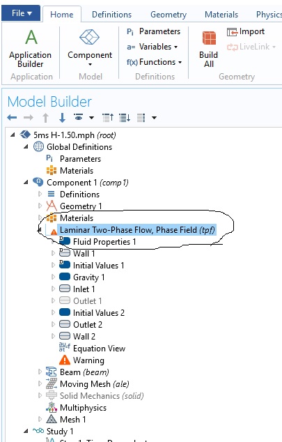

Hi, I hope someone more expert than me could help me. I want to open an old file (Comsol 4.2) into Comsol 5.3 but some physics such as (Two phase laminar flow) are changed and so the program give me a "warning". I want to use the new interface. There is a simply way to do this or I have to remake it in new comsol?

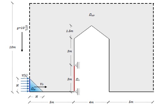

Thanks. When I open the file in 5.3 it works. The problem is that I want replace the old phisics (Two phase flow) with the new. When I try do rebuild model it doesnt't work. Specially when I introduce velocity condition becouse under gravity water collapse! Before it worken in 5.3 no. Why? You have some idea? Please help me :(
