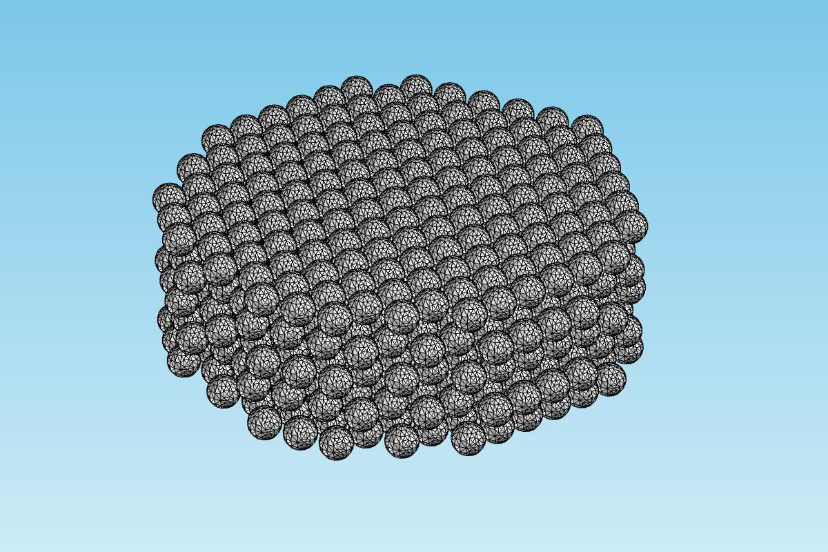

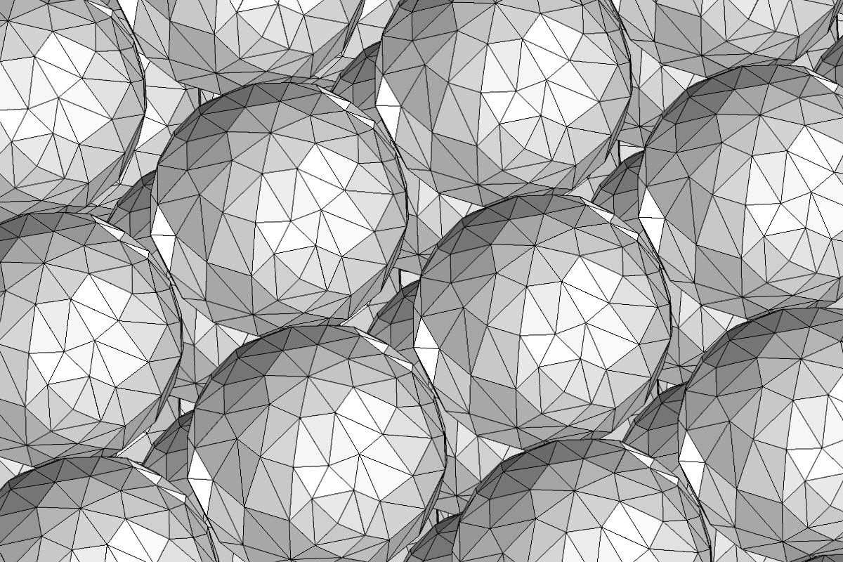

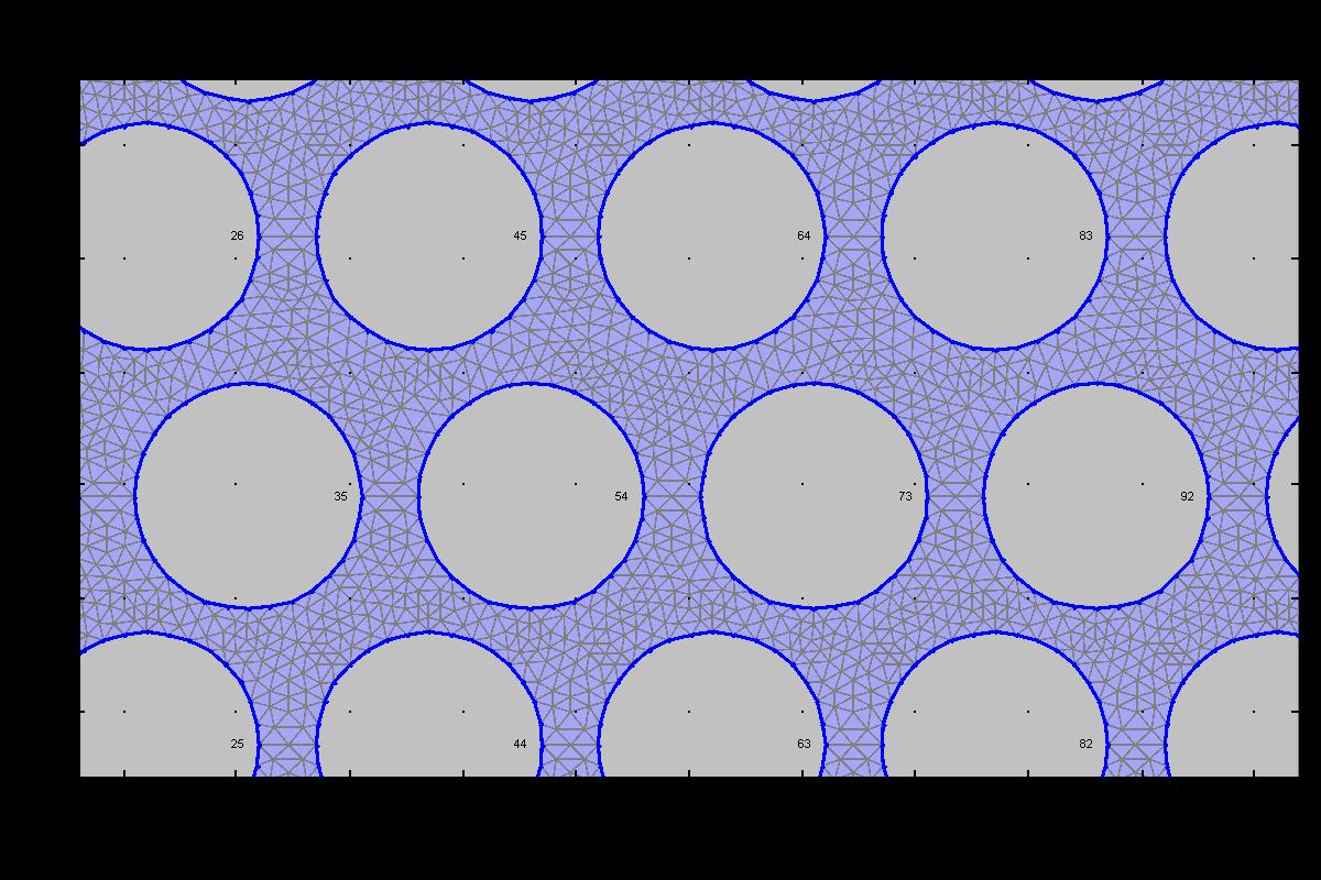

Its really not meshed. In 2D I can find an option to select the domain other than the spheres. But in 3D although there is domain selection option, I am not able to find out the free space between the spheres as a domain to mesh. I have attached two image files, one showing the geometry and the other clearly showing that the space between spheres is not meshed although I have done meshing in all the domains. This is because there is no such domain to select. How do I get the space between the spheres as a domain to mesh?

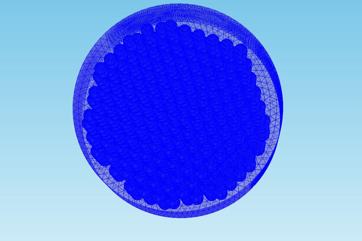

The geometry contains a cylinder around the packed bed of spheres. In order to show you the meshing between the spheres the container was kept hidden. Even the space between the container wall and packed bed was not meshed. Why am I not able to get the space as a domain in 3D where as in 2D I can easily select the space between the spheres as a domain. Please find the attached files which illustrates this.

try to visualize the mesh on a slice that intersects the whole assemly through the origin. If you have this cylinder in your geometry then there must be a domain.
It is just not straightforward to visualize a mesh in 3D space. You need a surface to do that. Like the surfaces of the spheres.
In space you need some kind of auxiliary surface and this can be achieved by a slice in post processing. I would really be surprised if this didn't show you the mesh.
