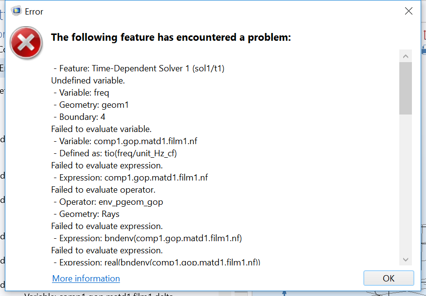

In this model "Thin Dielectric Film" boundary is used. So how can I add Frequency dependent material properties from an external file into Thin Dielectric film boundary condition?
I have defined my properties via interpolation table and renamed variable called "tio". Under Thin Dielectric Film BC, I recalled my function as "tio(freq)" however I got an error as attached.
What would be wrong?
