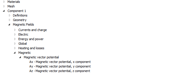

Hello! Is it possibly to calculate the magnetic vector potential in 3D AC/DC?

Magnetic Fields (mf) and Magnetic and Electric Fields (mef) physics interfaces solve 2nd Maxwell equation (Ampere law) in terms of Magnetic vector potential, which is primary dependent variable for these interfaces. Magnetic vector potential is available for post-processing, as shown in the attached image.
Regards, Sergei
