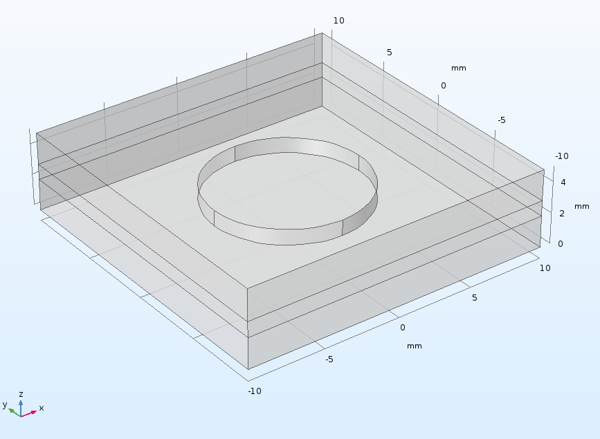

Dear all,
I am trying to make a very basic Eigenfrequency analysis. I have attached geometry which has a cylindrical hole in the middle. However Comsol wants me to assign a material through the hole as well where the hole suppose to be void.
Although I bypassed this problem by assigning Air into the hole and defined Poisson's ratio and Young's Modulus as zero, I am not sure if it is a proper solution.
I thank you in advance for your help, Best regards,

Hello Osman,
If you do not want to solve any equation in a particular part of your geometry (here, your cylinder), you should simply remove it from the geometry (Geometry>Boolean Operations>Difference).
If you need to solve some equations but not others in a part of your geometry, you need to be a bit more subtle and assign different domains to the different physics interfaces. From your post, this does not appear to be your case, but I am mentioning this for others who may read this thread some day.

Thank you very much for your response Jeff!
Actually I tried the "Difference" and I had the same problem. However I have just noticed that, "Keep input objects" were thicked under the Difference. I am sorry.
