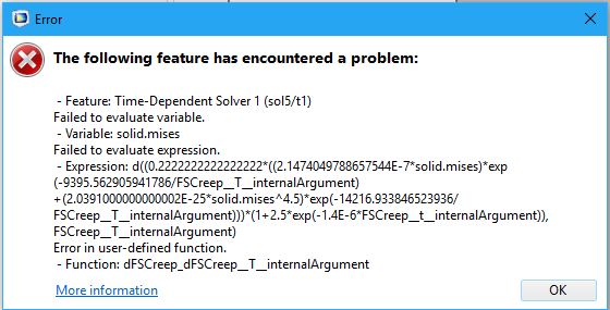

Posted: 7 years ago 2017/12/17 4:09 GMT-5
Hello Henrik,
Thanks for the response, it was very helpful.
I have used 'solid.mises' as the stress in the expression but I got an error, please find the attachment.
How can I solve this?
Regards, Faris
Hello Henrik, Thanks for the response, it was very helpful. I have used 'solid.mises' as the stress in the expression but I got an error, please find the attachment. How can I solve this? Regards, Faris
Posted: 7 years ago 2017/12/18 1:17 GMT-5
Hi Faris,
Your error message does not really give enough information, but it seems to contain two issues. One is related to a user defined function. The variable solid.mises in itself should be well defined, as long as the physics interface has the tag 'solid'.

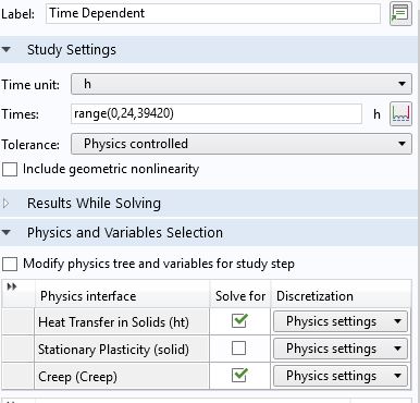

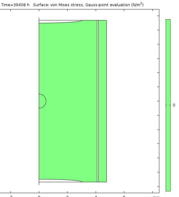

Posted: 7 years ago 2017/12/18 2:48 GMT-5
Dear Henrik,
I have solved the above problem as I used solid.mises in the creep function not as a global definition.
But I now have two problems:
1.In the time-dependent study step, if i solve for the solid mechanics (thermal expansion stresses), the solution does not converge. 2. If I remove the selection of the solid mechanics (thermal expansion stresses) when solving the time dependent study step, the creep stress result is zero.
Any possible issue causing that?
Thank you,
Faris

Posted: 7 years ago 2017/12/20 4:46 GMT-5
Hi Faris,
Your screenshot implies that you have three different physics interfaces. That would not be a standard appoach for the kind of simulation you have been outlining.
The coupling between the physics interfaces would become more complex in this case, because you would have to transfer stresses and strains. Is it really needed? If so, you should probably contact support.
