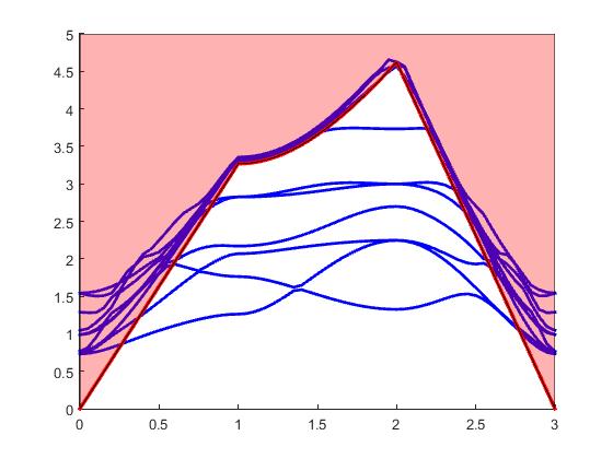

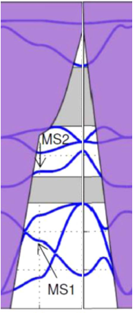

I am try to reproduce the result of a paper. On surface mode dispersion curve, I am not getting the dispersion curve similar to published article. In my case number of modes are more and Seudo- Surface wave modes in violate region is missing, which can be seen in published result. I contacted the author as well, what he suggest me is " you have to cut all the waves with group velocity slower than Rayleigh (or shear) wave in all the three directions of Brilluoin. Pay attention to the values of the wave-vector". I am still confused and did not understand how can I do that. Your comments are highly appreciated. Thank you
