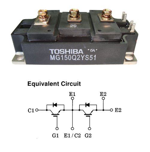

Hi Lvar,
I drew CAD model of igbt module where IGBT and diode is 70µm in height, and 10.23 mm x 9.73mm area. then i connected these chips by bonding wire and then i applied current 200A at one end. i enclosed the electical circuit of the model. please see. after drawing, i did meshing.. i selected proper material from library and in some cases i modified the value like Resistance, Expension coefficient due to temperature. but in solving, once i chose only the dc/emdc (conductive media dc) for physics settings and i found the solver is working but when i chose joule heating (DC + Ht). The solver shows errors during computing or during iteration. I drew couple of times the model very carefully to avoid geometric errors. but i couldn't find from where the errors are coming and it stops solving. i again enclosed a geometic CAD file. please see. in my model,

one side corner on the top, i applied a current of 400Am and another side is ground. which is isolated by Al203. 2 igbt with diode also isolated by Al2O3 but connect by bonding wire, please see cad file.
