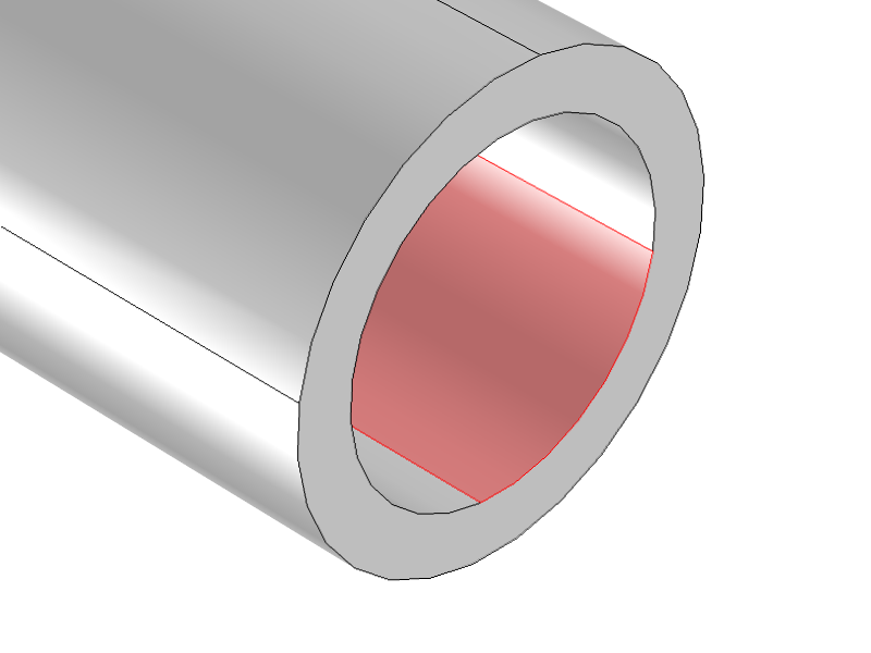

I have been able to draw a triangle in a work plane and sweep it along a cylindrical edge but there are a couple problems with this approach. The first is that for some reason COMSOL has divided my cylinder into four 'quadrants' (even though it is all one edge) so i have to preform 4 sweeps to get a complete circular thread. Secondly, I don't want a circular thread. I want the thread to follow a spiral along the face of the cylinder. I do not know how to draw this spiral on the cylinder faces (which is really a single face).
Attached is a photo of my model. In it you can see that i have a simple 3D solid I wish to place threads on the interior of (like a nut) and how COMSOL has divided the face in to quadrants.

yes indeed the "Helix" is for round sections, not closed 2D area created in a workplane, it looks like that this feature is not yet there, probably worth to remind "support" of a potential improvement :)
What is possible is to create a helix edge and then use a workplane to create a triangular shape and use the two for a sweep, but the twist compensation is not very good. And put your Face to sweep at the start of the line, else the result is somewhat surprising (top part)
