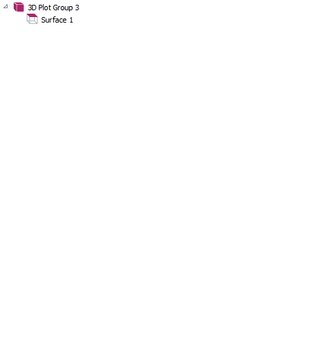

Phillip,
Since your geometry is 3D, you should use 3D Plot Grpoup/Surface, as shown in the attached image.
Sergei
Phillip, Since your geometry is 3D, you should use 3D Plot Grpoup/Surface, as shown in the attached image. Regards, Sergei
