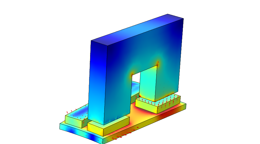

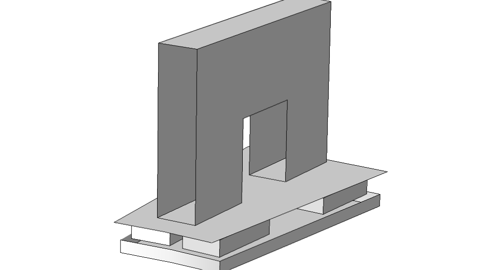

i set up a model of a rotating elctrical machine in 3D. So far the model is working, but i have a problem with the symmetry. I modeled 1/32 of the machine. If i rotate the rotor by several degree the field of the next sector seems to be missing or is in the wrong position. I attached 2 pictures to show you the problem. I think it has something to do with the sector symmetry, but i am not aware, what mistake i am doing.

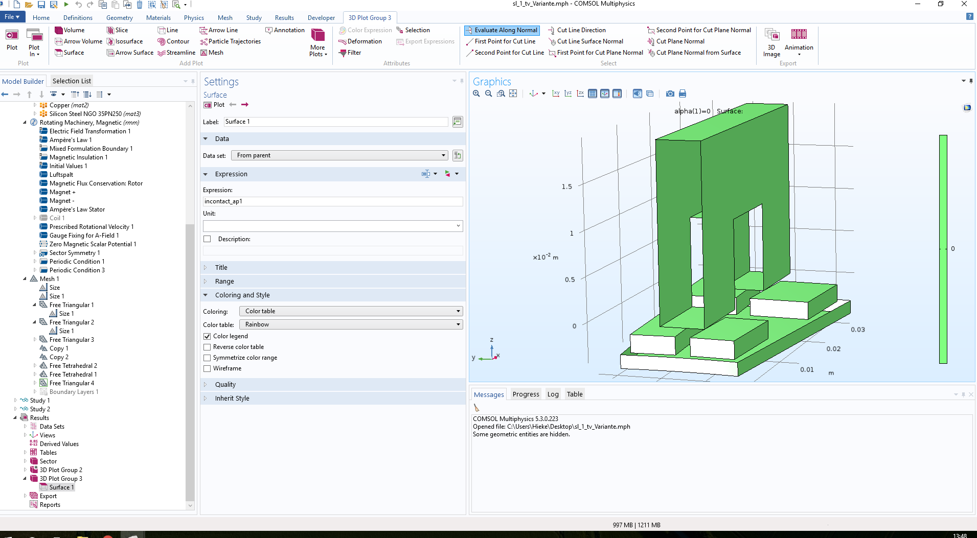

The axis of rotation is a setting needed in 3D - in 2D it is always the out-of-plane direction. It should denote the axis direction around which the rotor is revolving. It is important that the sector symmetry boundaries, that is the boundaries of the identity pair, lie on a cylinder (or other body of revolution) with an axis that is pointing in the given "axis of rotation" direction. If there are inconsistencies, for example if the geometry was not properly drawn or the "axis of rotation" was set incorrectly, the rotor-stator coupling in the sector symmetry condition may fail. You can test this by making a surface plot of the expression "1/incontact_ap1". This should result in unity (1/1) on the identity pair boundaries and inf (1/0) that will not render on the other boundaries. If there is a problem, it will show up as transparent patches on the identity pair boundaries (some elements not rendering).

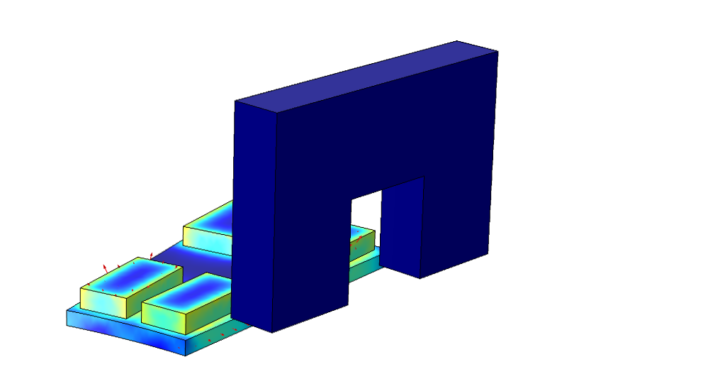

Hallo, i made a plot with the the expression. The first picture shows the identity pair (between U-core and the 4 magnets) and the second the plot with the expression. Obviously i made a mistake, when i applied the axis of rotation.
Is it possible to plot all of the sectors?
Hallo, i made a plot with the the expression. The first picture shows the identity pair (between U-core and the 4 magnets) and the second the plot with the expression. Obviously i made a mistake, when i applied the axis of rotation. Is it possible to plot all of the sectors?
