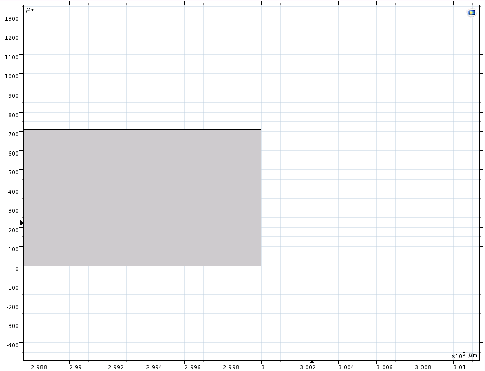

Dear Community,
I am trying to simulate the following case with COMSOL 5.3a. I have a 2D design of a Si wafer, with a layer of SiO2 on top of it (as shown in the picture). I want to apply different temperature values and find out at which T the two materials start to seperate from each other due to different CTEs; hence it is a thermal-mechanical study case.
However, I do not know how can I simulate that with COMSOL; the program shows me how the two materials expand due to elevated T as a unity, there is no 'seperation' between them.
Any help is welcome. Thank you in advance.

Dear Dimitros,
I would suggest you check out these two tutorial models:
https://www.comsol.de/model/thermal-expansion-in-a-mems-device-1870 https://www.comsol.de/model/mixed-mode-debonding-of-a-laminated-composite-19961
My impression is that a combination of these two could be an approach to the process you want to model.
Regards, Andreas

Hello Andreas,
thank you for the links! They seem really helpful!
