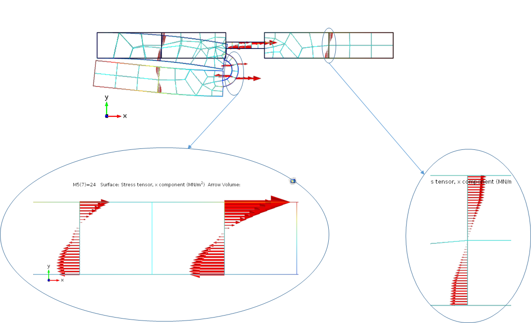

Hi Henrik,
I attached a photo where you can see the type of plots/diagram that I would like to generate.
Thanks in advance,
Jovana

Hi Jovana,
It seems like you want a Arrow Surface plot of the traction vector, (solid.Tax, solid.Tay, solid.Taz).
