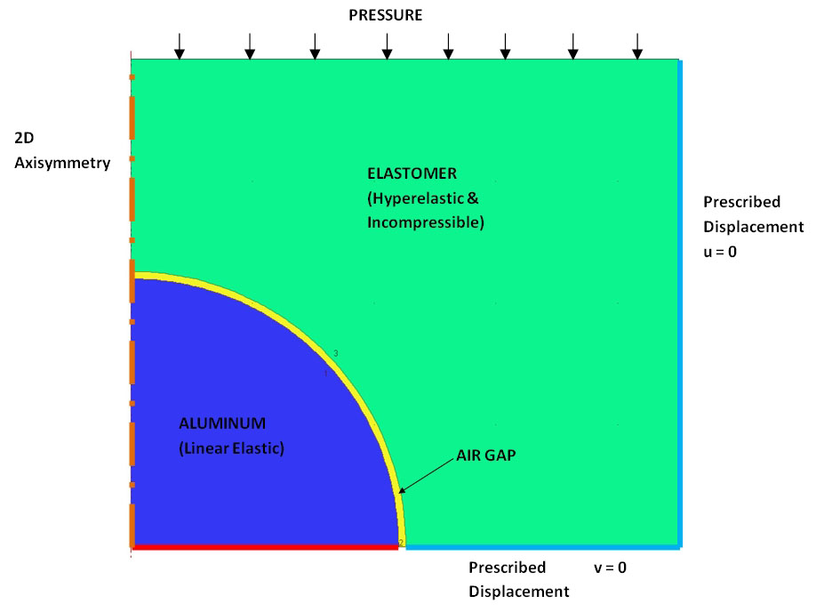

Hello everyone,
I would like your comments regarding the simulation I'm trying to do.
(See Schematic in attachment).
- 2D axisymmetrical model;
- Pressure load over an elastomer moving over a fix aluminum hemisphere (both separated by an air gap);
Goal: To get the pressure distribution over the hemisphere (i.e. to simulate the movement of the elastomer contacting the hemisphere due to pressure load).
Reading from the forums, I tried to simulate in the way Ivar was suggesting: considering the air gap as a "gelly-solid" with very low resistance but still considered a solid in the Solid Mechanics study. I don't know if it is valid in my case since the "air gap" should end up being entirely crushed and replaced by the pressurized elastomer.
My questions are:
- The displacement of the elastomer should cover the gap and contact the aluminum hemisphere. How to I simulate this? Do I really need to use the ALE moving mesh for that purpose?
- I don't need to know what's happening in the "air gap". Is there a way to remove it from the simulation but still being able to get the elastomer contacting the hemisphere? (I tried to use a contact pair but my model didn't converge)
Any comments/recommendations on how I should jump-start this again would be greatly appreciated.
Thanks!

I haven't deal with such problem, but I think that you can creat contact pair betwen AL and elastomer. You can set a initial displacement value in the boundary setting of contact pair when you consider model with air gap.
With or without air gap is not crucial in my opinion. Your problem is a contact model, "no convergence" may be the key point. The mesh, the initial condition and the parameters of solver may cause errors.

I believe the main issue you are facing is that in FEM with COMSOL (as well as most other FEM programmes) you cannot "fully crush" a domain, as you need some space to keep the existence of the mesh, else you are changing your topology which normally means renumbering of interfaces etc. Hence using 2 distinct models, one before contact, one after
Then you cannot set/define, in COMSOL, contact between internal boundaries (separated by a meshed volume in the same physics). You must at least use the "assembly mode and select the boundaries accordingly, then you need to maintain a minimum gap thickness (small but finite) to avoid the inverting of the mesh structure of your air.
In you case is the air gap really representative ? even to start with ? and is it a closed volume ?, in which case you need some additional equations to cope for the physics, rather than the "solid approach" that is too restrictive w.r.t physics.
You probably need the ALE for the elastomer I believe as you have often very large deformation of almost flow type there
