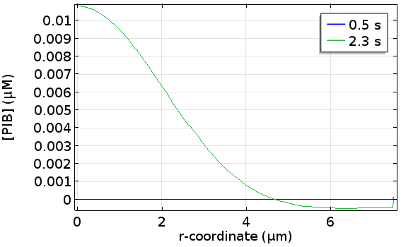

I have a model with a 2D axisymmetric geometry and now, for the postprocessing, I need a 1D plot line that goes from -r to r, instead of just 0 to r.

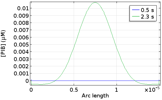

I used the 2D revolution, then "Cut Line" to define the line where I want to evaluate my results, and when I plot it it's ok, as long as I use "Arc Length" for my x-axis. When I change the expression to "r", it only plots my results from 0 to r. I tried to define a range for my x-axis using "range(-x,step,x)", but COMSOL doesn't accept that range as an expression.
I'm attaching a couple of figures so it's easier to understand what I mean. In both figures I used exactly the same data set (cut line), only changed the expression for x.

The Cut Line data set does not redefine the independent variables (space variables) in the underlying data sets, so, for example, r, x, y, and z will behave as they would before. In an axisymmetric geometry, it means that .
What you can do is to use an expression that includes the local space variable for the Cut Line data set, which you find in the Advanced section, which has the same values as the arc length: . If you name it r2, for example, and the radius of the geometry is, say, 0.5, then using an expression r2-0.5 will give you an x-axis than runs from -0.5 to 0.5.
