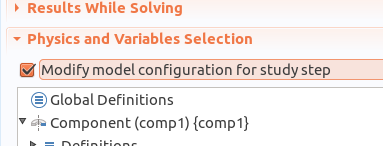

Hi Giulio,
Is the option "Modify model configuration for study step" in the Study Step configuration can do what you want ? Parts of the model can be activated of disabled here ...
Best regards, Etienne

Posted: 8 years ago 2018/02/27 9:45 GMT-5
Hi Giulio,
It is. I very apologise for having not noticied it by myself. Btw I'm using the version 6.3 of comsol and I only have the possibility to change the physics and not the geometry. However i suppressed the unwanted automodes fixing the displacement of the notA part to 0 .
Now I had another trouble: I change a geometrical feature on A and I perform the parametric eigenmode study. After that I want to study its first 3 eighenmodes with a time dependent solver.
I can't find a way to perform a parameter sweep only on a study step. Furthermore, every time i change the n (eigenmode number) the solver restart with a new mesh, even though nothing changed on the geometry of the system.
Thank you very much for your help. :)
