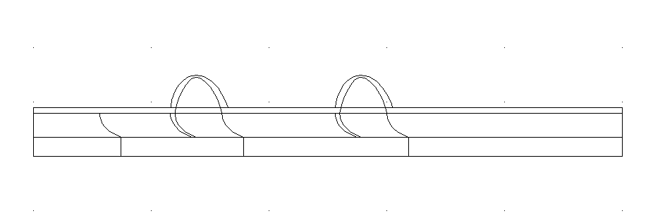

Here is my confusions:
About 2) the three segments in inlet 1 ,3,5 has the same conditions. Does I make some mistakes here?
3) inlet 2 , actually it is the inner boundary of the fluids, it has the same velocity as the inner boundary of the membrane.
4)boundary loads 1 and 3 , I want to do is they are like fixed, should I use the prescribed displacement? I check in the old version 3.5, it should use “standard notation" , Rx 0m Ry 0 m
7) prescribed mesh displacement is the membrane's mesh displacement, so I think it should be u2 and v2, is it right?
My model is about the single valve, the domain 4 8 9 13 15 is the solid membrane, when the flow enters from left to right, I need to find out how the membrane acts and how the fluids act.
Thank you so much!
