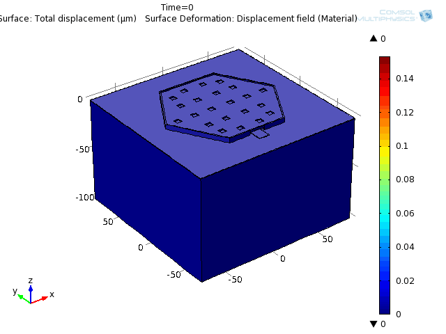

I am trying similar problem. What I am trying to do a structural mechanics simulation on a capacitive sensor to simulate a vibration and then find the capacitance change with respect to vibration. It means I am doing a vibration simulation and then a electrostatics simulation to find the capacitance change. Is it possible in COMSOL?

Thanks for the answer. I am using a time dependent simulation. I have created the vibration with a "prescribed displacement"(at structural mechanics module). But after that I need to find the capacitance simulation. I need to find the capacitance each time.I am attaching a file that will explain what I have done yet.

Well either you calculate the capacity with the ACDC module physics by using the calculated field, or you calculate / integrate the average distance versus area to get the capacity of a plane paralle plate
Both, in your case, should give similar results (5-10%), at least from my understanding of your model (but I might be wrong as "just" an image is not really enough to understand all the subtilities ;)

Thanks for the information. you have written that "Well either you calculate the capacity with the ACDC module physics by using the calculated field"-Thats right I also wanted to do that, but i dont know how I can do that . I have tutorial that computes the static capacitance but not the capacitances which will change with time.I also do not know how I can do multiple step simulation.
