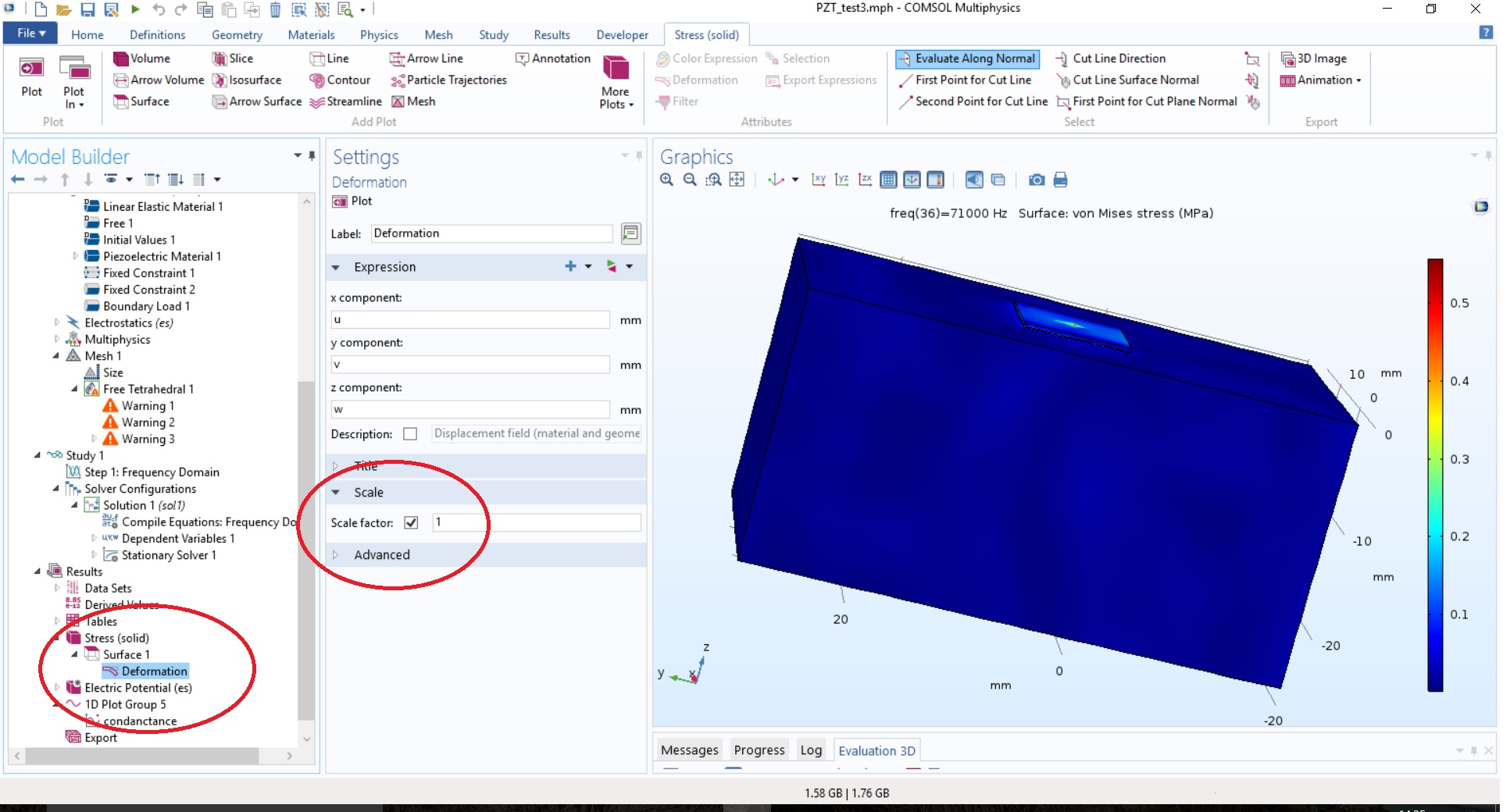

There is another level of settings for the graphs, for instance under Stress (solid) > Surface 1 > Deformation where this setting is located.

Results-->Stress-->Surface 1-->Deformation-->You will find Scale over there. Just change the scale factor to 1. :)
Follow this Results-->Stress-->Surface 1-->Deformation-->You will find Scale over there. Just change the scale factor to 1. :)
