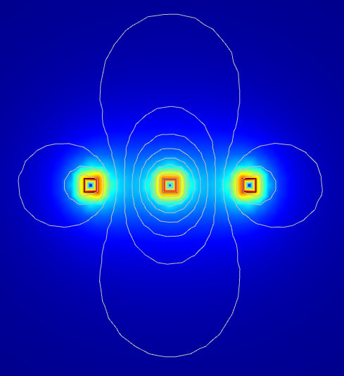

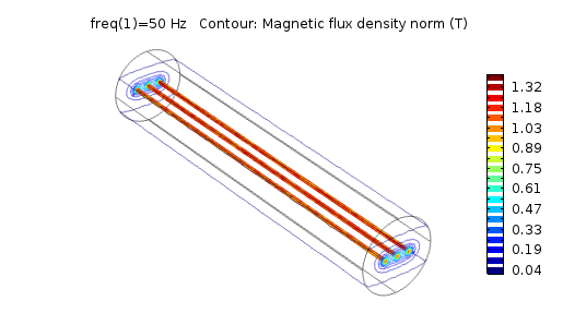

I am trying to make a model that can model the electromagnetic field lines and force field strength for a three phase system. I have made the models, but the system will for some reason not converge.
When i try to converge, I get following message: Feature: Stationary Solver 2 (sol1/s2) Undefined value found. - Detail: NaN or Inf found when solving linear system using MUMPS.
