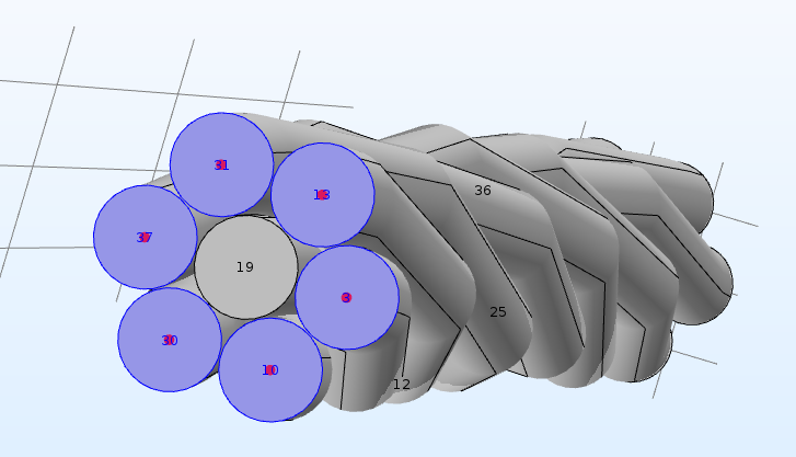

I am trying to model a stranded overhead line conductor of the type ACSR (aluminum conductor-steel reinforced) in 3D Magnetic Fields (mf), Frequency Domain, and I can't get my model to converge. For simplicity I've started out with a single steel core and one layer of helically stranded aluminum layer around the steel core. For the aluminum strands I use the Helix primitive in the Geometry. Form Union and Form Assembly have both been tried out (know the difference between these), and I've tried with and without any physically contact between the single strands.
For the coil domain, I've added coil Inputs to one end of the aluminum strands (see attached image) and Output to the other ends and added the necessary Coil Geometry Analysis under at first position under Study.

  1. You don't have air domain enclosing you coil - so no physically maningfull results can be expected with Mahentic Fields physics interface without surrounding air.
  2. After adding air domain, make sure that you have closed loop for the current flow in your coil.
  3. Central steel wire is included in the coil domain but no current excitation is assigned to this wire, which doesnt'n make much physical sence.
